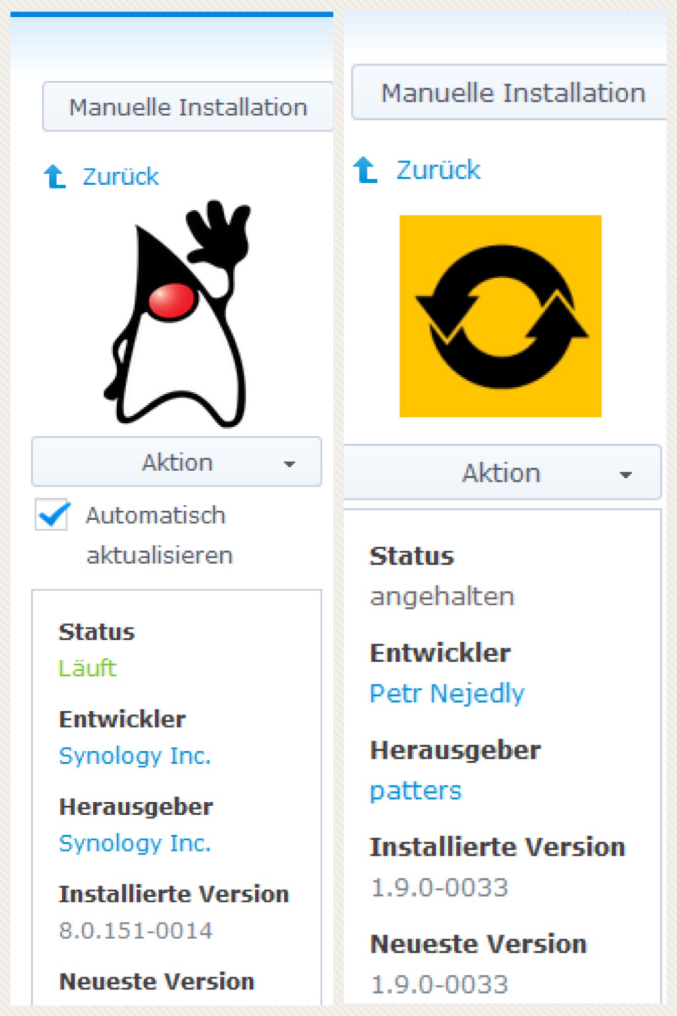

I installed the Java8 Package from Synology and then Serviio. both installation installed well, but when i start serviio it stopps after a few seconds. if I´m fast enough i can connect from firefox but i see not much.
sorry about my englih :-). Maybe some Screenshots are helpful.

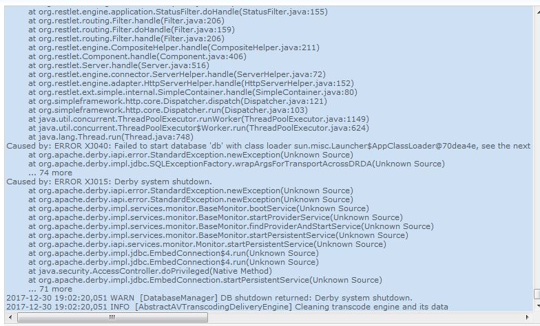

I have the same problem
LOG
Posts: 5531
Post Fri Dec 29, 2017 10:30 pm
Re: Service always stopp on synology DS18play (armv8?)
Neo, that is a rather small portion of the log, but my guess is that it can't find Java on your NAS. I can't help with installing Java, but that looks like the issue.
