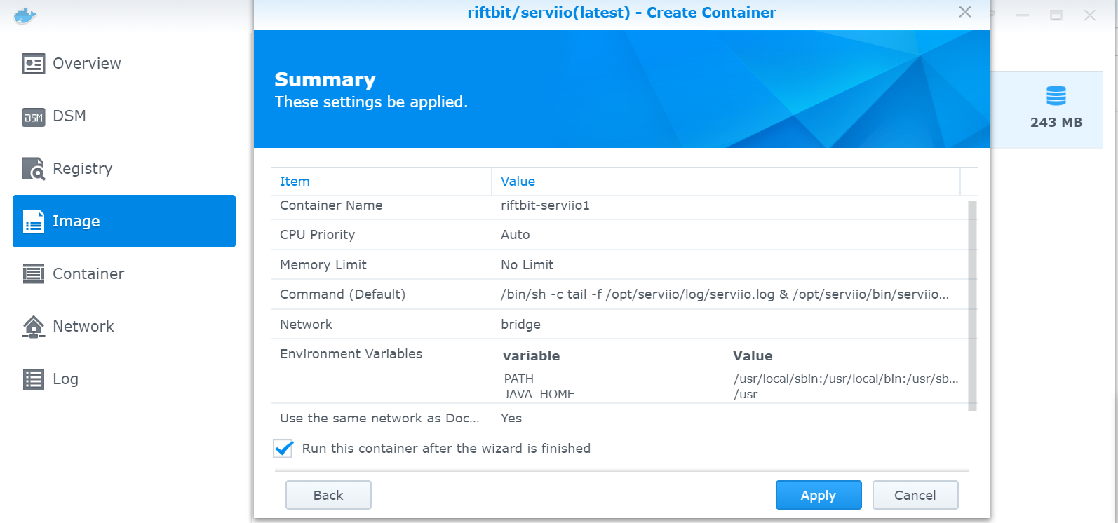

Okey, this is what i do.
1. Stopped current NAS serviio 1.9.2 from packages.
2. Installed Docker.
3. In Docker/Registry i search for Serviio and from list i select "riftbit/serviio" and download this image last version.
4. Now under Docker/Images i see "riftbit/serviio:latest" image 243 MB.
5. I select under Docker/Images the downloaded "riftbit/serviio:latest" and clicking "Launch" button.
6. In "Create Container" settings i select Advanced Settings/Network. I mark there "Use the same network as Docker host". (See picture 1)
7. Now i tried to connect to console. "Page not found"
I allmost started to uninstall it but i did last try after 1-2 minutes. Wow i got connection to console. I have no idea why it didn't worked immediately.
http:// your lan ip :23423/console/#/app/welcome

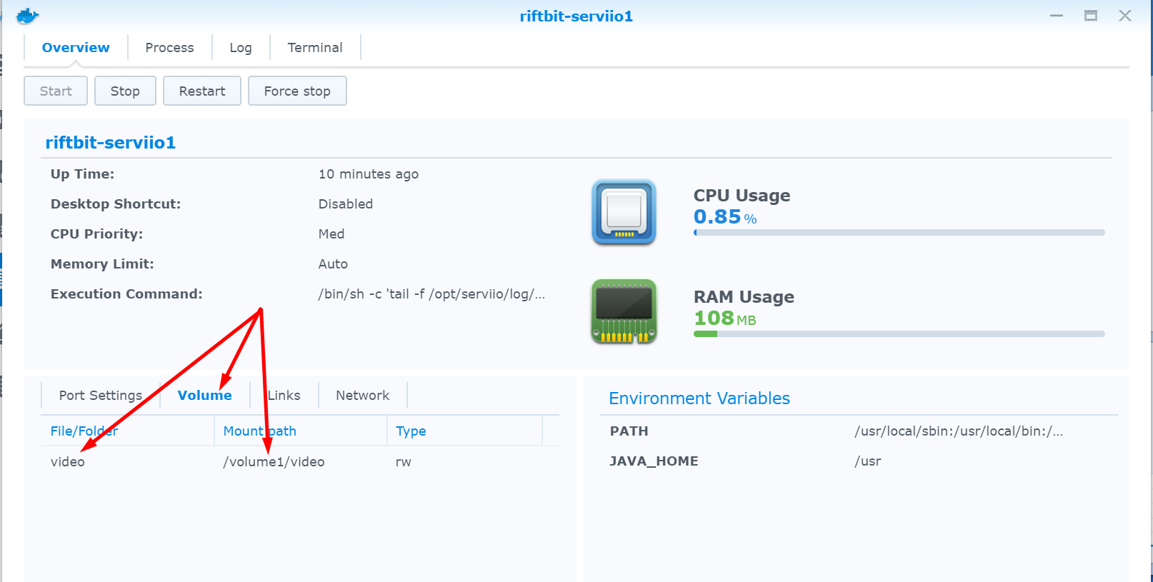

8. So next problem was unable to see my media files. I forgot to setup path. My media folder is called "videos". Its a shared folders. So who have saeme problem please see picture 2.
And now it seems working. I have to test it.

Meelis > correct settings is: File/Folder = your existing shared folder with your videos (i have there folder with all my files), Mouth path = /media/serviio
see here: https://hub.docker.com/r/riftbit/serviio/ this: [/media/serviio - put media content here and add in serviio gui this path]

HI! I am a maintainer (developer) of this container, and i am glad that someone uses it :) But i never tested it on NASes or something else of bare-metal servers :) And this thread can be a good feedback for me :)
About ur problem in 7. - it is not problem of the container. You cant get access to web console immediately because serviio java service starting not so fast :) If u will check logs of container you will see moment when it ready to accept connections. It need 30-60 seconds to fully start.
About 8. - u need to bind any folder with your media files. I binds:
    host - /media/hdd
    path in container - /media/serviio
And then in serviio gui i navigate path /media/serviio/....<here your content of mounted folder>.....
Like on screenshot:
Folder VIDEO is in host path /media/hdd
If someone have problems with setup feel free to open an issue on github page: https://github.com/riftbit/docker-serviio/issues
P.S. Serviio v 2.0 container will be released today or tomorrow :)
Best regards and sorry for bad English, it is not native for me :)

triks
Joined: Sat Mar 14, 2020 5:46 am
Post Sat Mar 14, 2020 6:01 am
Re: Serviio docker
For my Synology / Docker / Serviio image I used riftbit-serviio image.
Working well but DO NOT map volume /opt/serviio/config (at least for me that caused the docker image to crash).
