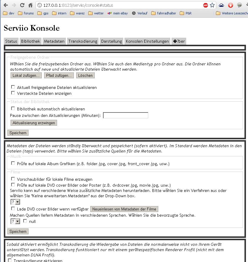

it seems to be running but the webUI contains no data, see attached screen shot.
what i'm missing?
Post Mon Aug 01, 2011 12:00 pm
Re: Web UI in Restful Ajax
williMeier wrote:great tool, tankyou!
what i'm missing?
+1 Same problem for me on Firefox or IE
what i'm missing?
Is javascript enabled?

williMeier
Posts: 16
Joined: Sun Jul 31, 2011 9:33 pm
Post Thu Aug 04, 2011 11:56 pm
yes. tried with chrome, ie 8, firefox portable, opera.
