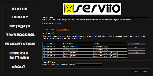

As requested obviourly i did it as concept and may not be possible but should be fine on tablets and high end photos in landscape setting.
console design.png (17.9 KiB) Viewed 19607 times
Post Sun Dec 18, 2011 9:53 am
Re: Android Console
Cerberus wrote:As requested obviourly i did it as concept and may not be possible but should be fine on tablets and high end photos in landscape setting.
Thank you for putting the effor in, and once I get the core backend working, I will definately work on the colouring in general, and the layout where needed.
The problem is although I can (and will) supply alternative layouts to go from small portrait phones upto lanscape tablets, they have to share similar fundimentals else 1) I'll be writing alot of the gui code twice 2) the app will on some devices act in two very different modes depending on the orientation. The problem with following zip's original console layout, is there just is not enough space on phones to fit it all in. Additionally, its designed for a constant connection which is less likely in a mobile app so I have to add extra UI elements and code to account for that.
But don't worry, I will be running it in an emulator I have setup for tablets, its just harder to test as the emulator only uses one cpu core so is quite slow with tablet size screens.
