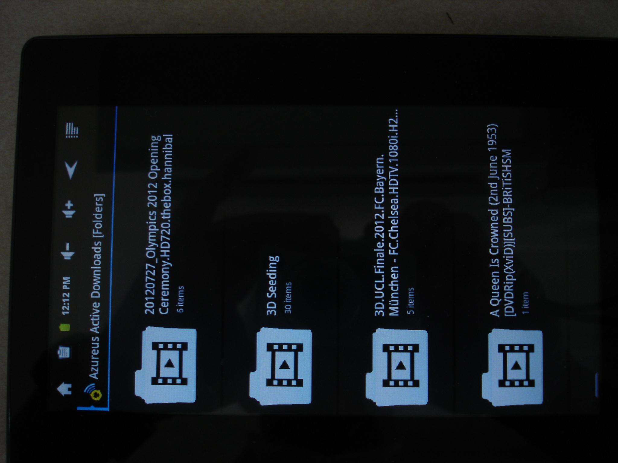

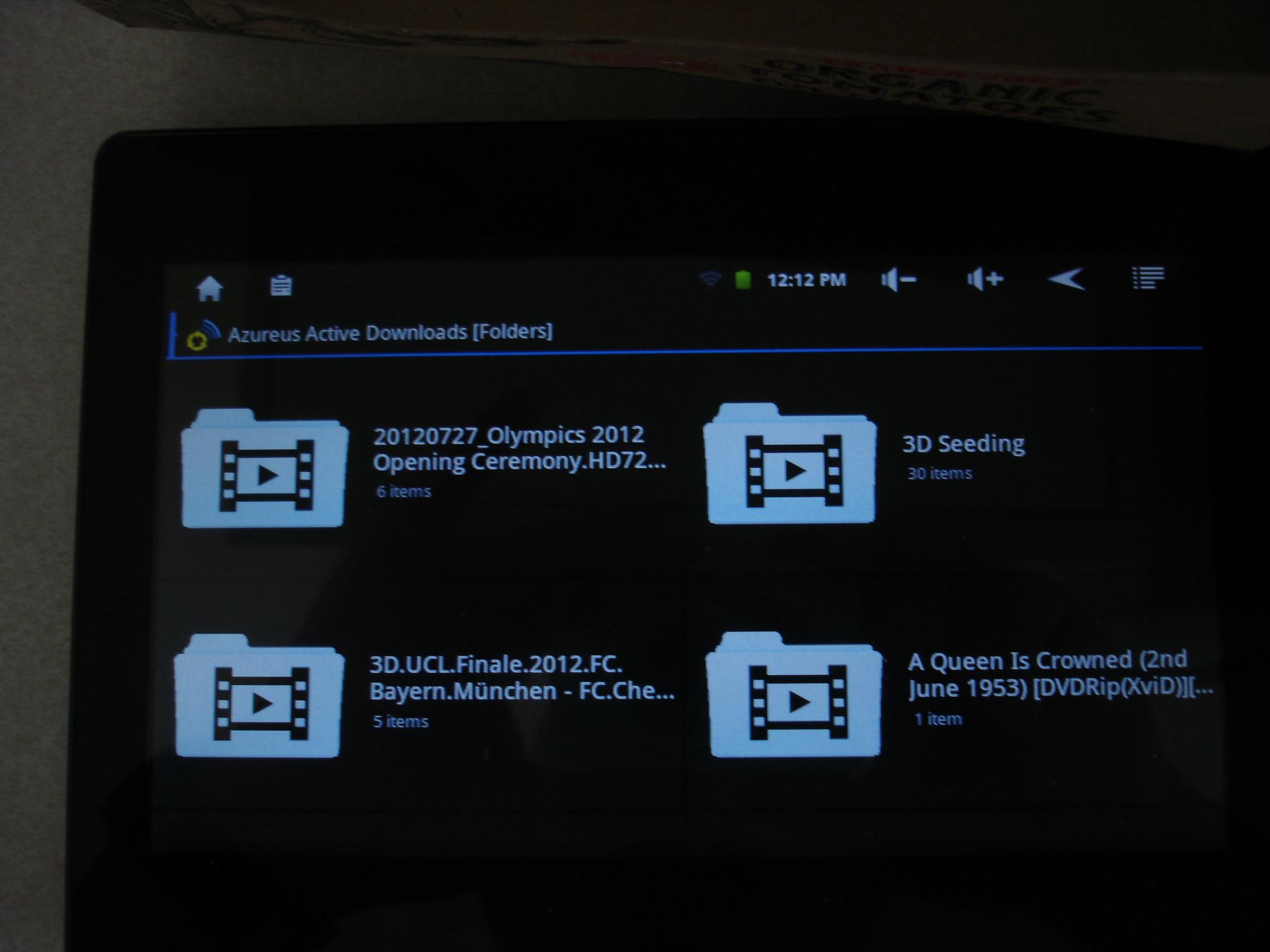

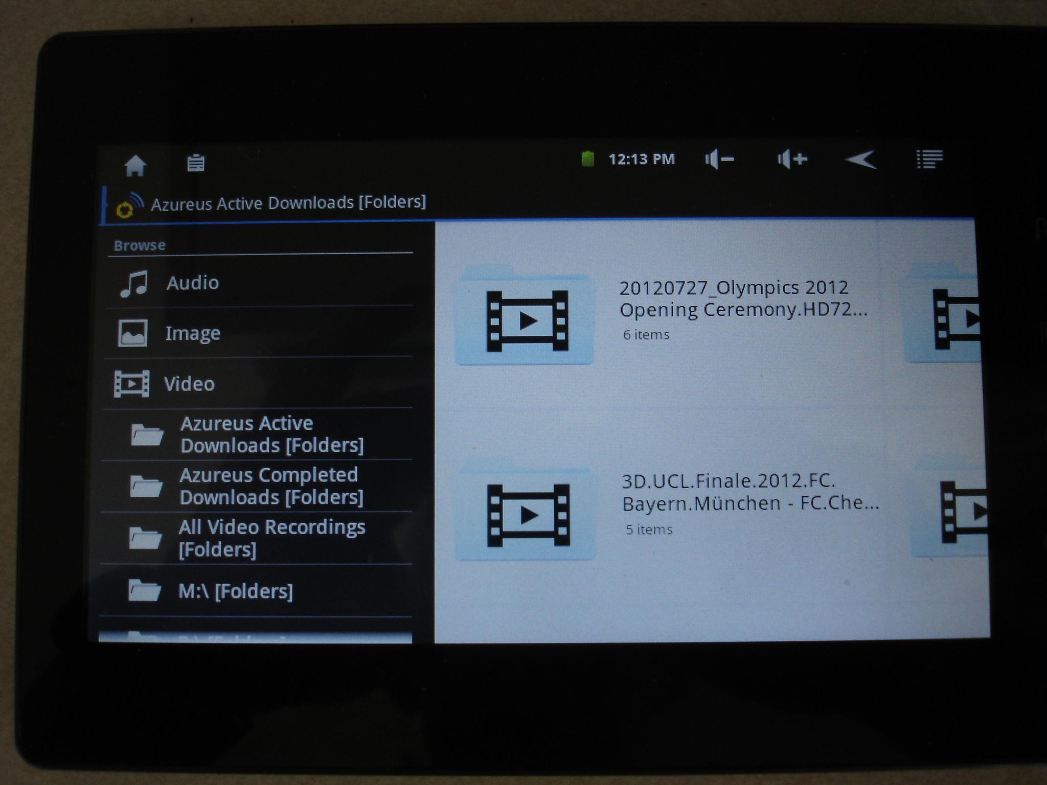

Post Mon Feb 18, 2013 9:59 pm
online fixed
folders still just 2 lines - see 2 pics
browse menu pics - 1. shows still dark when rest light. 2. shows light background with no black text when 1. is slid up or down.
dark browse menu when light theme
folder 2
folder 1

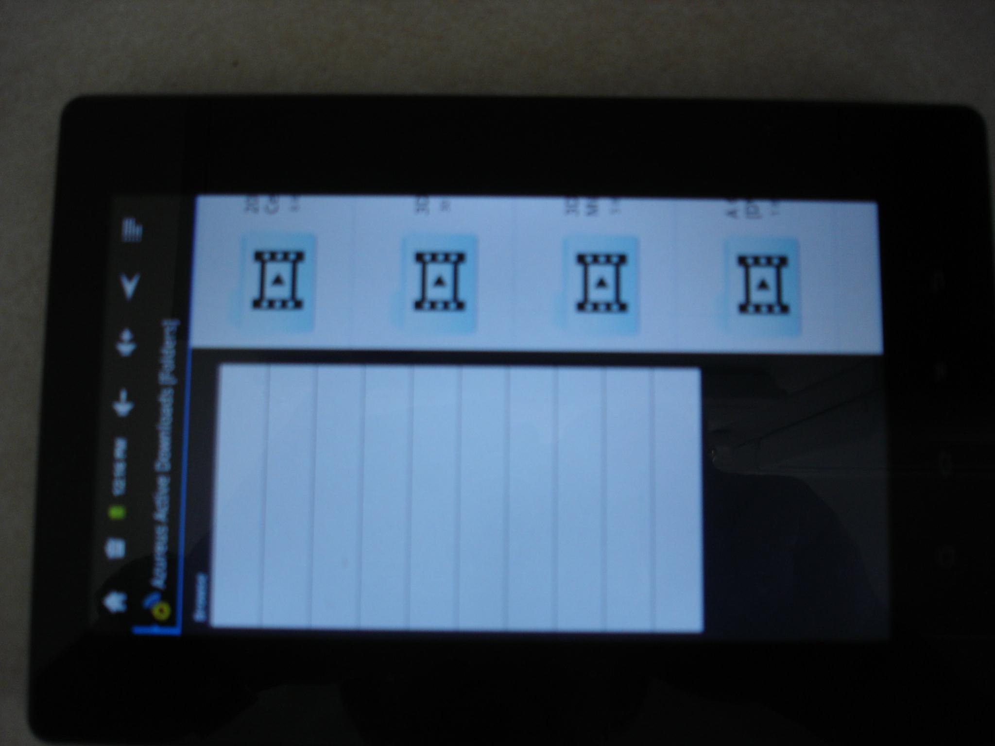

Post Mon Feb 18, 2013 10:00 pm
attachment 4
white browse menu when slid
Post Mon Feb 18, 2013 10:10 pm
OK, just did some research and there is a bug in Android's code, if you ask the text view to display "..." when the text goes over the num line limit it is limited to 2 lines regardless of what you set it to. There are some simple enough workarounds that shouldn't impact performance so I'll try those later this week.
Sidebar problem, OK thanks that helps as it means it is in the list of options, rather than the whole side fragment, still no idea what is happening but that should help track it down (hopefully), very odd.
