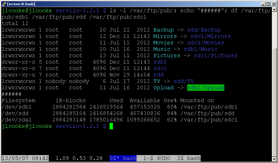

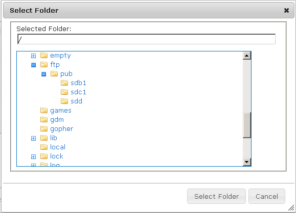

Howdy WebUI Team,
Can you take a peak at my issue on this thread [http://forum.serviio.org/viewtopic.php?f=5&t=6821&p=69075#p69075]
Basically, the webui doesn't seem to want to cross devices. Is this an issue in serviio or the WebUI?
Serviio WebUI 1.4beta running against serviio-1.2.1:
Actual file system:

jlcooke
Posts: 22
Joined: Wed May 30, 2012 7:46 pm
Post Tue May 07, 2013 1:45 pm
Re: Web UI in PHP (revised)
mpemberton5 wrote:Hey jlcooke,
What type of partition are these mounts?
They're SATA drives mounted as EXT-4 FS.
mpemberton5 wrote:What PHP version are you running?
PHP 5.4.9 (cli) (built: Nov 22 2012 10:03:10)
Copyright (c) 1997-2012 The PHP Group
Zend Engine v2.4.0, Copyright (c) 1998-2012 Zend Technologies
mpemberton5 wrote:Have you tried changing some of the permissions? I've not tested it, but wondering if scandir() is tripping up there.
Permissions in the screenshots show 755 for all the top-level folders for the mount points. And inside it's just as permissive.
I tried doing this on my machine:
echo '<?php print_r( scandir("/var/ftp/pub") );'|php
and got this:
Array
    [0] => .
    [1] => ..
    [2] => Backup
    [3] => Mirrors
    [4] => Movies
    [5] => Music
    [6] => Pictures
    [7] => TV
    [8] => Upload
    [9] => sdb1
    [10] => sdc1
    [11] => sdd

Great info. So it looks like we should be able to eliminate the partition type and PHP version. Nice. One other thing, is your virtual directory in Apache set to follow symbolic links (FollowSymLinks)? This might be where our problem is.
The Folder Tree code that I use was from a third party and here's the code they use:
if( file_exists($base.$dir.$file) && $file != '.' && $file != '..' && is_dir($base.$dir.$file)){
   if(check_for_subdirs($base.$dir.$file)==true){
      echo '<li><a href="#" class="collapsed" rel="'.$dir.$file.'/"></a><a href="'.$dir.$file.'/" class="folder">'.$file.'</a></li>';
   }else{
      echo '<li><a href="#" class="nosubs" rel="'.$dir.$file.'/"></a><a href="'.$dir.$file.'/" class="folder">'.$file.'</a></li>';
Since the symbolic links aren't showing, it's not making it past the first if statement. So, run these two commands to see what responses we get:
echo '<?php print_r( file_exists("/var/ftp/pub/Music") );'|php
echo '<?php print_r( is_dir("/var/ftp/pub/Music") );'|php
One of those are probably failing. Also, try this to see what it gives:
echo '<?php print_r( is_link("/var/ftp/pub/Music") );'|php

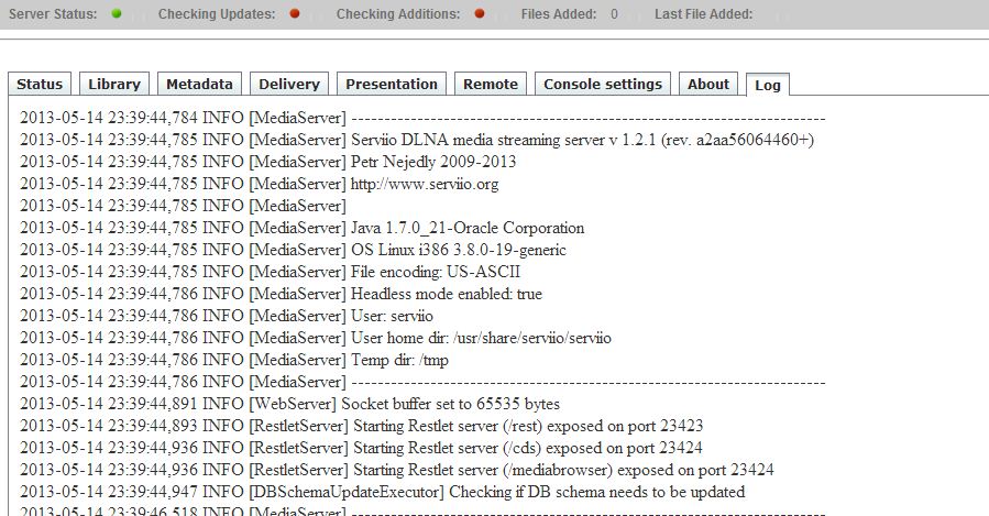

Show Logs in Console (only useful for headless or NAS Serviio servers) - Others please do not attempt.
Please make a backup of files you need to modify.
If you are like me, running serviio in an ubuntu headless or in a NAS, and constantly using IOS Devices or ServiioWeb to manage the serviio, also frequently having to use ssh
or WinSCP to review the serviio log, then this post might just for you. This adds serviio Log tab to ServiioWeb and displays current logs once clicked.
1. ServiioWeb/config.php add following to line 12 and modify log folder location as necessary.
$log = "/usr/share/serviio/log/serviio.log";
2. ServiioWeb/content.php - replace line 9 with following:
if ($tab!="library" && $tab!="metadata" && $tab!="delivery" && $tab!="about" && $tab!="presentation" && $tab!="remote" && $tab!="settings" && $tab!="about" && $tab!="log") {
3. ServiioWeb/index.php - add following line to index.php at line 359
<li><a href="content.php?tab=log" rel="indexcontainer"><?php echo tr('tab_log','Log')?></a></li>
4. save following code as log.php in ServiioWeb/view folder.
<html>
<head>
<title>Show Serviio Log</title>
</head>
<body>
<?php
include("../config.php");
$file = fopen( $log, "r") or exit('<strong><span style="color:#FF0000;text-align:left;"> Unable to open Serviio log file! </span></strong>');
//Output a line of the file until the end is reached
while(!feof($file))
  echo fgets($file). "<br>";
fclose($file);
</body>
</html>
NPuser

Wow this is cool, finally no more WinSCP to see what's going on my QNAP Server.
Does it auto refresh?
Would be even cooler it can be formatted, ie view only errors, view my date
About tab should be at the end.
