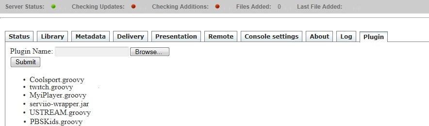

Post Sun May 26, 2013 5:48 pm
Re: Web UI in PHP (revised)
Thanks for looking into incorporating 'Log' into webconsole.
For me at-least, i hardly change the serviio settings once i have everything the way i wanted. However, i still use serviioweb console to manage the contents/sources as well as unfortunately use other 3rd party apps for few other things like logs, plugin management, CPU usage by both Java and FFmpeg processes, and lastly the server reboot. I would think webconsole is in a perfect position to leverage its flexibility to manage just bit more than just vanilla serviio settings. Of course it is easier said than done as someone actually have to put their precious time and effort in to this but i though i just put it out there. We can't thank enough to both Mark and Swoop for keeping this project alive.
I would loved to be able to do following from webconsole:
1. View Log
2. View Installed Plugins with version Install (too bad not all plug dev following version numbering)
3. Update/Install Plugins - [i have a semi working version of this feature - pic below]
4. View basic server resource usage - CPU, Memory as well as processes Java and ffmpeg (i use webmin for now)
5. Reboot the server
6. Also, mediabrowser in the webconsole with iframe but with an option to launch separate session with a click
thanks

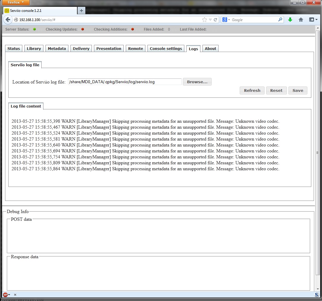

Post Mon May 27, 2013 2:10 pm
Hi guys,
played a little bit around with the log file output so this is what came out ;)
Still some work left on the browse button though...
1. View Log
1. Done ;)
2. Should be a quick one
3. Would need some work
4. Could be part of the log tab
5. Reboot the system or Serviio as Media Server?
6. Next to play with, I guess...
Cheers!
Serviio log.jpg (259.38 KiB) Viewed 54537 times
