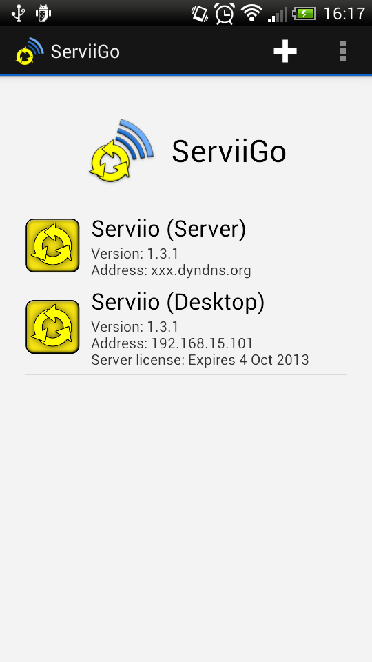

Post Sun Sep 29, 2013 3:06 pm
So this is what you get if you try to connect to a fresh install of 1.0 (unsupported version + evaluation license) when using automatic setup.
If the server's license has expired, then the orange text turns red and gives the alternative message. If you use manual setup, then you get a toast message that says pretty much the same thing.
And this is what you get after adding a server with an eval license.
So i'm hoping these changes will make it completely obvious to users and end the problems of people not realising that Serviio Pro is required until after their trial expires.
Btw, I said previously in 3.0.4 that I had fixed connecting to an old server, I hadn't :(, but that is now fixed (although if you try automatic setup on something pre 1.0, then you will probably get an unknown error/failed to connect).
I'm hoping to release 3.1 publically next weekend assuming the new automatic setup works on older devices (it should do, or at least, if the previous one worked this should work) so please try to actively break it.
Also, if you ever get 'Cannot read subtitles' error in the internal video player, please send me the subtitles file so that I can add support.
