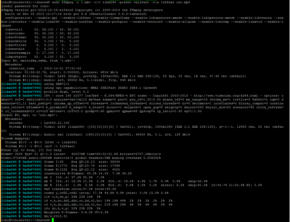

Edit: I looked how to exec ffmpeg and runned for an 9gb 1920x1080p/ac3 mkv movie to -aac/mp4
with preset veryfast - 45-50 fps -- ffmpeg -i 1.mkv -c:v libx264 -preset veryfast -c:a libfaac out.mp4 (picture attached, I manually stopped when fps were stable)
with preset medium 20-30 fps
EDIT2: changed output size to 846x480 - medium and it gets 100 fps !!! Is it possible it has something to do with the .ts segments???
ffmpeg -i 1.mkv -c:v libx264 -preset veryfast -s 846x480 -c:a libfaac out.mp4

Can you try Menu - Settings - Video Settings - Force External, then play the video back in MX Player and go Menu - Tools - Properties and check the url has an authToken param on it.
Ok, MX Player is not giving me nothing, but could get a screenshot of VLC that gives an URL for a couple seconds.
http://to.. .:23424/cds/resources/18384/MEDIA_ITEM/HLS-O/
Post Sat Dec 21, 2013 8:06 am
There are supposed to be some parameters at the end of that url, however, VLC might be hiding them.
Just to double check, which version of ServiiGo are you using, and what version of the server. I still haven't had access to a laptop yet but should do tonight so will be able to check the logs and make some suggestions.
tonovcp
Joined: Sun Dec 15, 2013 11:05 pm
Post Sat Dec 21, 2013 3:02 pm
will wrote:There are supposed to be some parameters at the end of that url, however, VLC might be hiding them.
Latest, just installed. I found in VLC this.
2013-12-21 15.58.32.png (395.73 KiB) Viewed 22453 times
