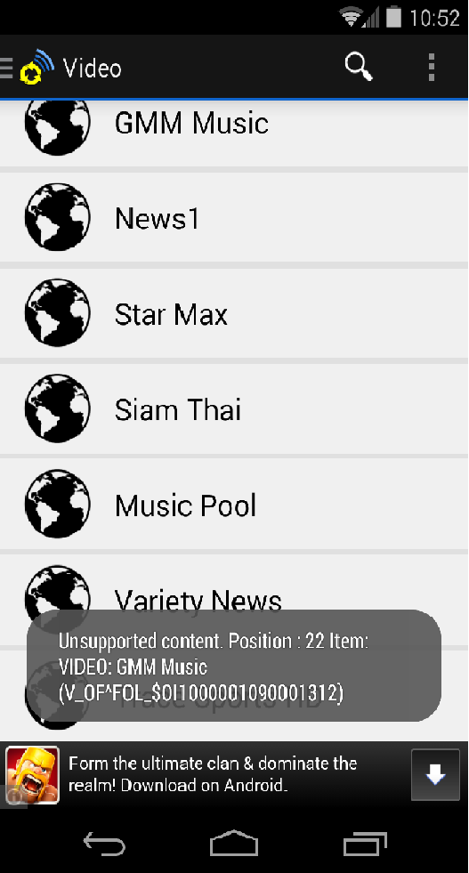

Post Sun Jan 19, 2014 12:03 am
I recently started using ServiiGo on my Nexus 5. I attempted to open each one of my online sources resulting in error attached.
Here are a few of the URL's of the online sources (which work on my PC in media browser and on my TV with a DLNA player etc):
http://110.164.192.112:1935/LiveStream/ ... ylist.m3u8
Has anyone else had this issue or could provide some assistance please.
Post Sun Jan 19, 2014 8:39 am
That's strange. Are you using Display Content Only in the presentation settings?
adski
Posts: 13
Joined: Sat Aug 10, 2013 11:32 am
Post Sun Jan 19, 2014 9:25 am
will wrote:That's strange. Are you using Display Content Only in the presentation settings?
yep, sure am... would that cause the error?
EDIT: seems that when display content only is select then it doesn't allow selection of external player? its working now. Thanks very much!
Post Sun Jan 19, 2014 9:31 am
I've just been doing a quick test, and yes that is almost certainly the cause. While I did have a TODO in my code, there isn't anything there at the moment to handle items at the very top.
Can you quickly confirm that turning that option off fixes the problem?
In the short term, the best solution is probably to ignore user preference over display content only.
adski
Posts: 13
Post Sun Jan 19, 2014 9:56 am
I can confirm that changing from "Display content only" to "Display category" does fix the issue.

Post Sun Jan 19, 2014 10:05 am
OK thanks. At the moment, there is a fundemental assumption that the first screen the user sees only has containers, and doesn't have any items/files.
In the short term for 3.3 (may even get the first beta out tonight), I can ignore the display content only setting by requesting data with an without the user options turned on and then combine the results (thus allowing you to use display content only on your other devices), so that uder ServiiGo you see Online and then get the list of sources.
Then for 4.0 when I'm planning on updating the UI and browsing experience, I'll add some extra checks so that if all of the items only come from one place, (i.e. you don't have display content only on for movies and online sources), then display them properly as per user preference. (If it doesn't turn out to be too awkward, this may go into 3.3)
Does that sound OK?

Post Sun Jan 19, 2014 5:14 pm
I've just uploaded 3.3 Beta 1 to Google Play.
While it was a bit awkward, it didn't really work unless I did it properly, so I have implmented the following.
If a single category is set to 'Display Content Only' and all other categories for that media type are set to 'Disabled', then it is displayed correctly, as if you had already navigated into it.
If at lest one category is set to 'Display Content Only' and at lest one category is set to 'Display Category' OR two or more one categories are set to 'Display Content Only', then the items from the categories that are set to 'Display Content Only' will be replaced with their category container, just as if they were actually set to 'Display Category'. A side effect of this is response caching must be disabled for this view (as its made up of two different responses and the cache doesn't support the processing required), it also requires Serviio 1.4.
So in your case, where you only have Online set to display content only, you will see what you want to see.
