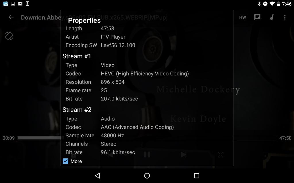

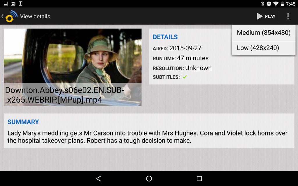

Post Wed Dec 16, 2015 1:24 am
h265 Playback
I have an h265/aac.mp4 file per below, which plays natively using MX player on Android 6.0 (see image)
MX plays original
When I play it under ServiiGo, (either profile) it will only play under MEDIUM and LOW after transcoding to MPEG2.(see image)
Only Medium and Low
Why can't I play the ORIGINAL?

csholmq
Posts: 139
Joined: Sun Mar 25, 2012 11:41 pm
Post Wed Dec 16, 2015 6:31 am
Re: h265 Playback
jhb50 wrote:I have an h265/aac.mp4 file per below, which plays natively using MX player on Android 6.0 (see image)

Could you catch the ffmpeg call?

Post Wed Dec 16, 2015 7:59 am
Looks like one for zip, Serviio should always send the Original version to ServiiGo. Do you get original as an option under MediaBrowser? Have you made any changes to the profiles?
Post Wed Dec 16, 2015 4:04 pm
Command is per serviigo-standard medium profile untouched.
command = "C:\Program Files\Serviio\lib\ffmpeg.exe" -threads 3 -i "D:\Azureus Active Downloads\Transmission Downloads\Downton.Abbey.s06e02.x265\Downton.Abbey.s06e02.EN.SUB.x265.WEBRIP.[MPup].mp4" -y -threads 3 -c:v mpeg2video -pix_fmt yuv420p -b:v 1000k -maxrate:v 1000k -bufsize:v 1000k -vf scale=854:480 -r 25 -g 15 -c:a libmp3lame -b:a 128k -ac 2 -map 0:0 -map 0:1 -sn -f mpegts D:\TEMP\Serviio\transcoding-temp-29803-serviigo_standard-MEDIUM.stf
I think the reason is that there is no MediaFormatProfile for any HEVC video/x-h265 format videos. Maybe 1.6 has them.
Post Thu Dec 17, 2015 8:37 am
jhb50 wrote:I think the reason is that there is no MediaFormatProfile for any HEVC video/x-h265 format videos. Maybe 1.6 has them.
Yes - h265 is not a standard DLNA profile, so it's not really supported. Only via transcoding. It would work in MKV, as it's not supported at all but Serviio serves it anyway as a made up media profile. I could do the same thing for h265 in mp4 ... create a ticket pls.

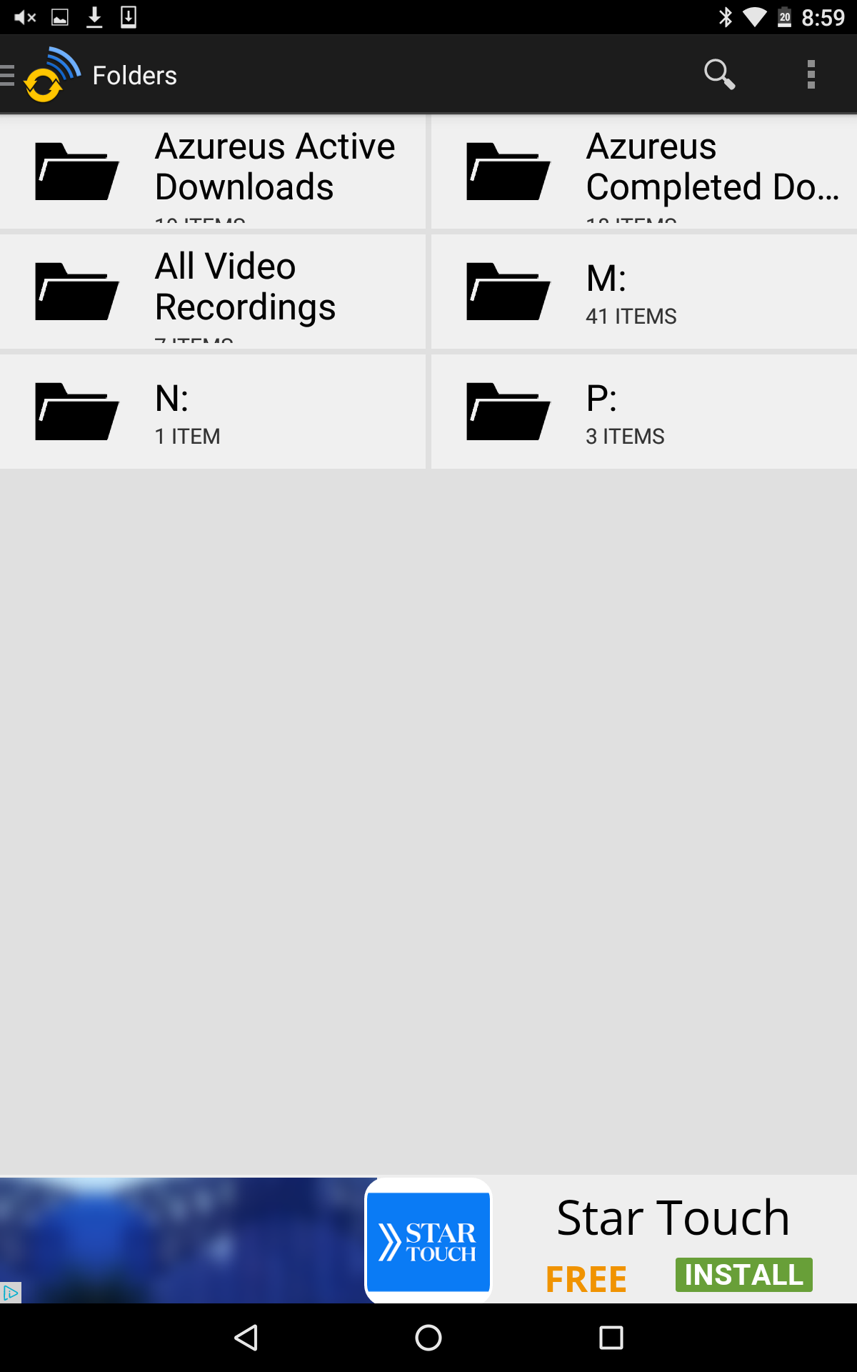

Post Sun Jan 03, 2016 2:15 am
See attached screenshots for some layout problems that cut off the item counts.
Post Sun Jan 03, 2016 10:06 am
Gokia wrote:@Will 1st of all thanks for all your work.
Do you think that the issue #54 Will be in your next Serviigo update?
Thank you
Not in the next one, want to do it based on Chromecast workflow first, then extend it. I've been working on the next beta for far to long now so want to try and get it finished up sooner rather than later so won't be putting in many features.
jhb50 wrote:See attached screenshots for some layout problems that cut off the item counts.
Thanks, what device (or screen size/dpi)?
Post Sun Jan 03, 2016 1:59 pm
Hi Will. Nexus 7(2013)-Android 6-1920×1200 pixel display (323 pixels per inch; 127 ppcm),
