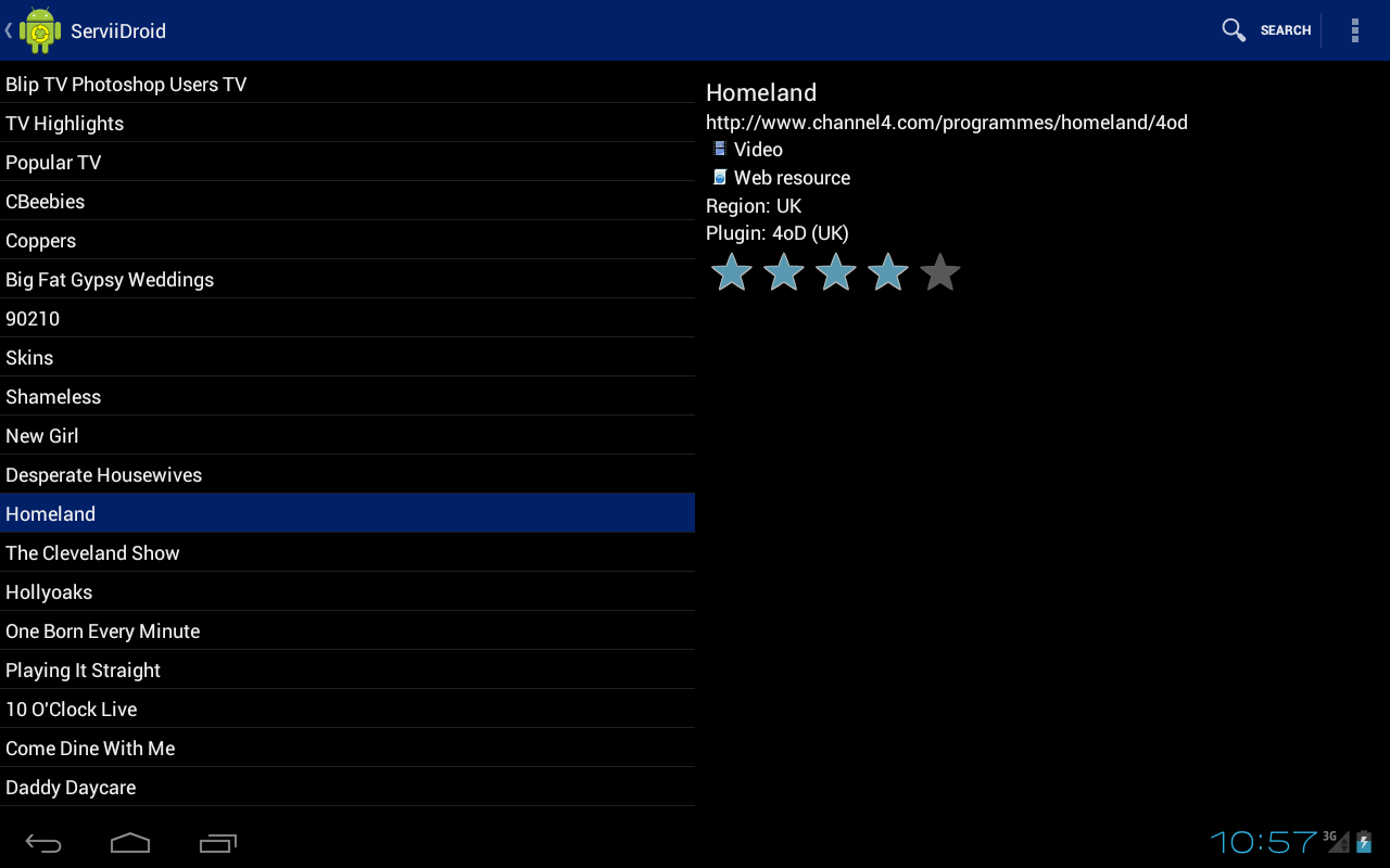

Made some good progress this morning. The API seems pretty responsive (much more than when loading the website). I guess the items are comming out in the order they were added in to the databaase, if it is easier to do it at your end, then it might be nice to sort them a bit first.
I think you should definately add installCount and rating to the response, maybe even add the extra info such as resolution, category and langues as well. If you later extend the API, i can let people rate a show via the app.
This is what I have so far, obviously the UI needs sorting out properly (missing text and sizing in general), and I need buttons to add to library, but I think it should work really well.
