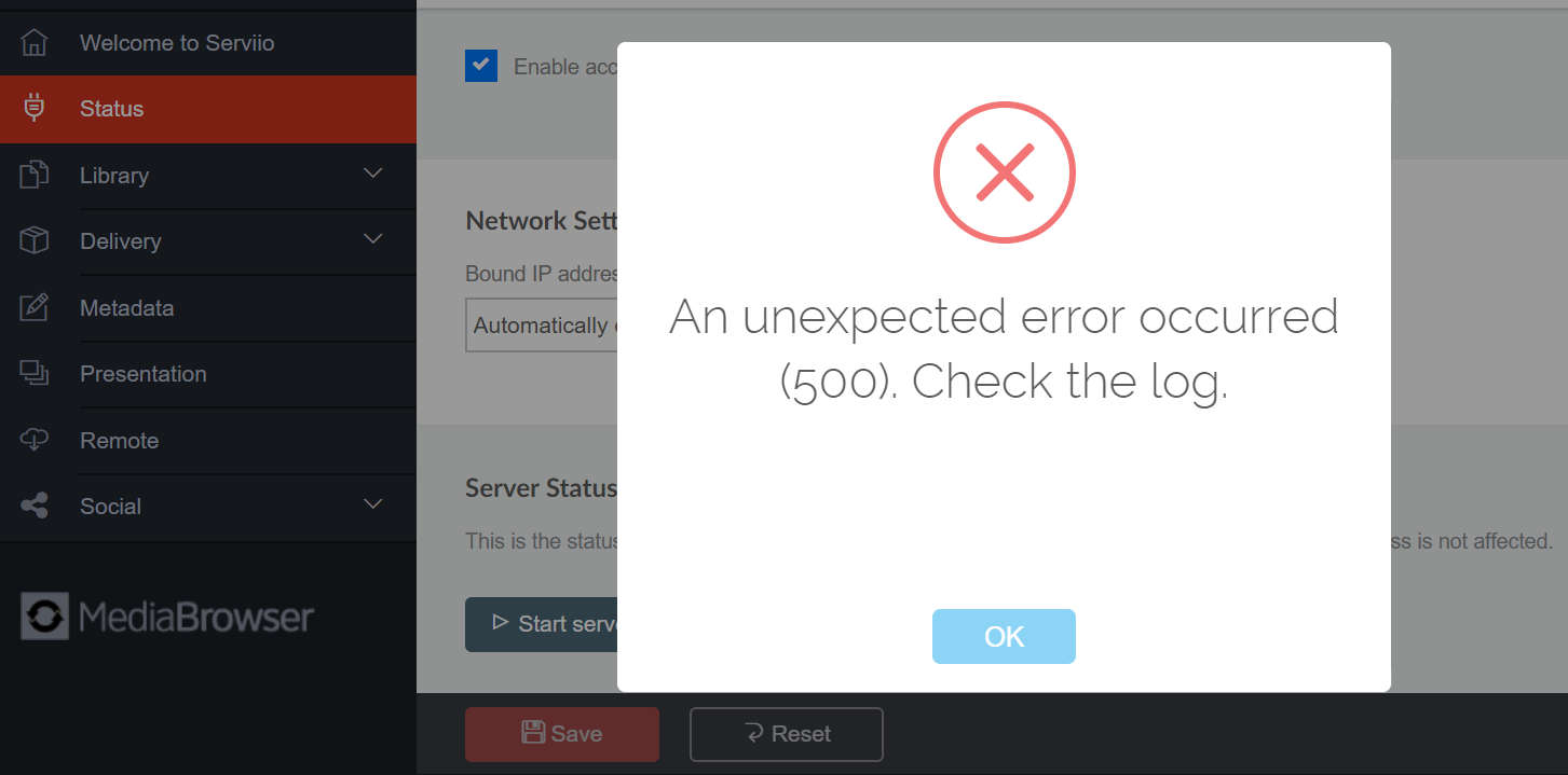

Today i tried to add new profile to NAS and i am stuck. Seems i am doing something wrong or missing something. I am getting error.
What i did... I copy user-profiles.xml to config folder and got that error.
Then i did try to add this code to profiles.xml file like the rest profiles are there. Again same error. :? What i am doing wrong? Didn't found much help from forum here.
So, i restored original files. Serviio working but i was unable to add new profile what i need.
serviio error.png (75.54 KiB) Viewed 44868 times
