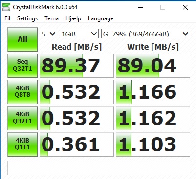

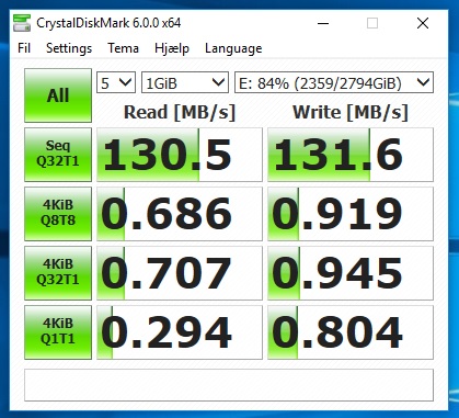

and i have also make a write and read test " PLEASE SEE PICTURE"
it is only reading and writting with 130 mb/s
SEAGATE Skyhawk Surveillance 3 TB HDD »ST3000VX010«

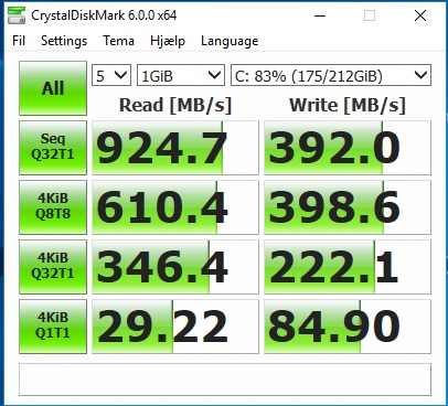

Now i have also copy the demo to the C where i have 2x SSD in Raid but i get the same symtoms.
and they have a read around 928 mb/s and write around 400mb/s, please see picture.

I believe you might be misunderstanding those speed tests. Notice the speed is in MB, not Mb. The capitalization makes a difference. MB is megabyte, while Mb is megabit. Even your slowest hard drive (89 MB/s) is reporting over 700 Mb/s read speed, far faster than even the highest bitrate 4K video. So even streaming speed from the external drive is enough for 4K streaming, just not more than one at a time most likely.
