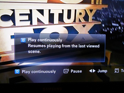

Post Wed Mar 02, 2011 6:08 pm
Re: Resume video playback on Samsung TVs
Tested 0.5.1 beta on Samsung UE40C6500UW, works perfectly.
Thanks to everyone who made this great feature come true. :D
serviio 0.5.1 resume playback.jpg (58.43 KiB) Viewed 31250 times
