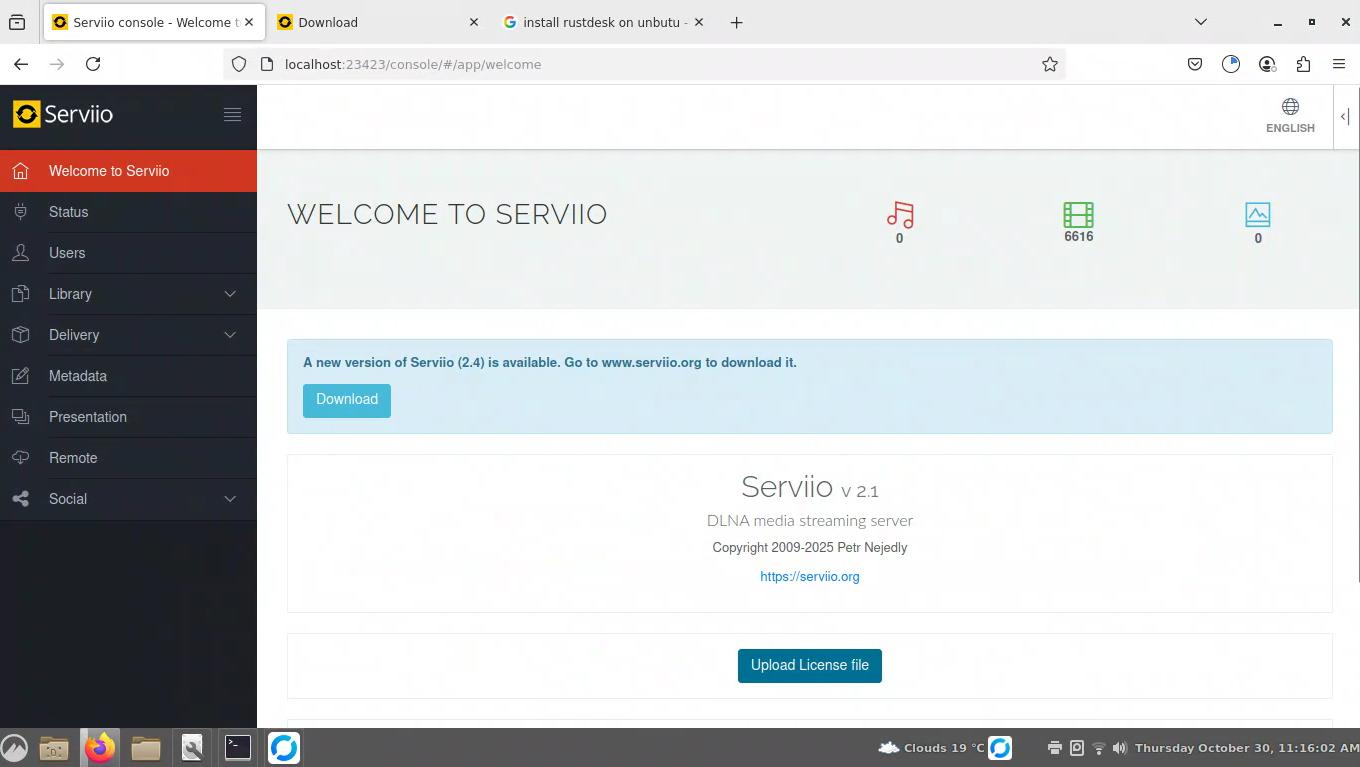

As far as reaching the Serviio console, are you looking for a console app or just using a web browser? I'm not certain Linux builds have the console app, but even on Windows I just use the web interface. From any computer on your network just access http://[Serviio IP address]:23423/console. When you're on the Serviio computer itself, just use localhost instead of the IP address.

The console has no login, only the MediaBrowser. The URL is slightly different for the console and MediaBrowser:
console: http://[Serviio IP address]:23423/console
MB: http://[Serviio IP address]:23424/mediabrowser
Notice the different port number (the number after the colon).

Well I got into the browser OK and the console came up OK, thanks for that I'm on version 2.1, is it worth upgrading ? and how is it done via the command line

I just have to point you to the release notes for you to decide if you want the latest version. Version 2.1 is now over 5 years old, and I'm pretty sure there's some worthwhile improvements in it. https://serviio.org/news
I can't remember exactly how you update Serviio on Linux. If I remember correctly you simply unzip the main file and then copy everything over the existing install. But I can't be sure of that, so check the website for more details.

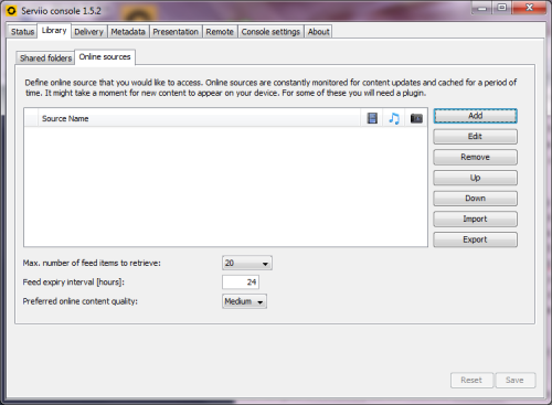

I've been looking for the Serviio GUI for ubuntu as I stated before, I remember using it but had to install java to get it going, I can't seem to find any thing on it other than an image on what it used to looking like
but as you said 5 years that's how long since I've touch this Linux box lol, its all up to date now

It's been a long, long time since I've used the console app. The web version does everything and I don't need to worry about if it's on a specific computer. :D
