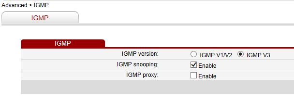

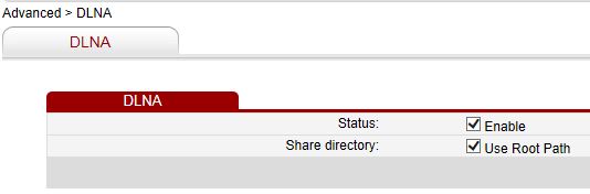

ncstone
Posts: 12
Joined: Mon Aug 26, 2013 11:30 pm
Post Mon Feb 03, 2014 9:32 am
Re: Solution to 30 minute disconnect problem (v1.2.1)
I have had a look at my router settings which is a talktalk HG533 and cant find any multicasting options I have attached my DLNA settings and IGMP can anyone tell me if IGMP V3 could be the issue? My router has options to change it to V1/V2 not sure if this would make a difference, I also could not find any option for IPv6.
Cheers
IGMP Settings
DLNA Settings
pcbrand
Joined: Sat Aug 13, 2011 4:58 pm
Post Tue Feb 11, 2014 4:57 pm
I haven't played with IGMP myself, but if I understand the protocol correctly it is used to manage multiple multicast groups on a network, I never really needed something like this with my small home network.
I could be wrong but it seems like your devices need to be part of the same IGMP group in order to participate in or listen to multicast with each other...
IGMP is a router protocol so I am not sure if your non-router devices need to be "IGMP aware" in order to properly participate or it is just enough for the router to manage it, however based on how IGMP is implemented on your router it could actually be filtering out some devices on your network by having them in groups.
What happens if you turn IGMP off?
Alternatively - if IGMP membership is user configurable on the router you could manually add all of your devices to the same IGMP group and that should work.
If you have additional routers on the network - they really should be IGMP aware in order to work properly.
