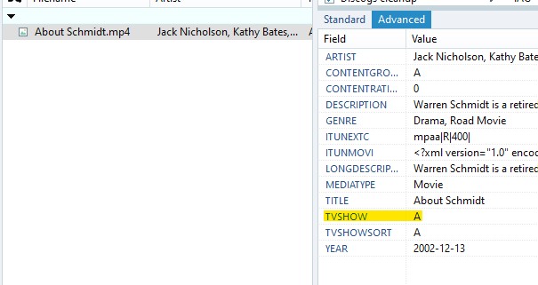

Thank you guys for helping with this. It appears that Serviio is doing exactly what it is being told by the embedded metadata. I used TagScanner and 'MP4 Video and Audio Tag Editor' to confirm that there were other metadata fields that I could see with neither Windows Properties nor Mp3Tag that were somehow set to define the files as TV Shows under the parent folder's name (in this case my alphabetized structure).
TagScanner names the field TVShow, MP4 Vid uses the simple name of Show. By removing these entries, when I refresh the metadata in Serviio, all returns to expected outputs.
So now I have nearly 1000 movies to update! The two tools mentioned above are one at a time tools...any suggestions on apps that could scan, pull online data and rewrite en masse? Or one that can load more than one and can write just the metadata back to the file without resaving the entire move file?
