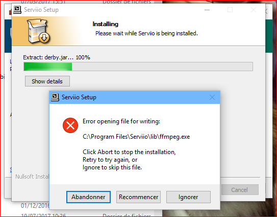

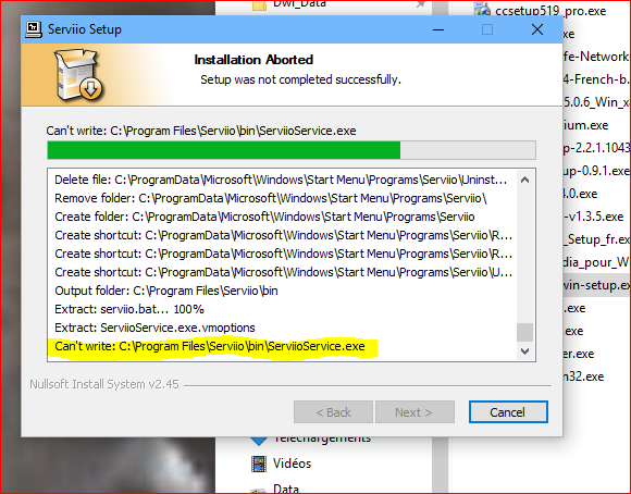

I uninstall 1.8 and try to install 1.9 ang get these errors messages :
Now unable to uninstall or reinstall serviio , I follow the link in thee forum to the topic of the ffmepg update but was impossible to upgrade the file in the \lib folder.

serviioservice.exe error
ffmepg error
Post Sun Nov 12, 2017 9:49 pm
Re: Solution to 30 minute disconnect problem (v1.2.1)
I know it's been quite a while since you posted. My apologies for not responding sooner. I just overlooked it. :oops:
Those two errors that you provided screenshots for (thank you!) could be the same problem or could be two different things. First, the first error appears to be a permissions issue. Even though your user account may have administrator rights, sometimes you still need to take the extra step when installing and right-click the install file and select "Run as Administrator".
The second error could be the same issue as above, or it could be that ffmpeg is in use and can't be altered. Windows (unlike Linux) will not allow a file to be altered (replaced, removed or renamed) if it is in use. That makes me think that something (in this case Serviio itself) was still transcoding a file. Remember that simply stopping a video playback does not stop the transcoding process. If you open task manager and view processes by all users (that's the default in Windows 10, but 7 and earlier default to only processes running under your user account), chances are you'll see ffmpeg still running. The solution is to stop the ffmpeg process, and then you can attempt the install again.
