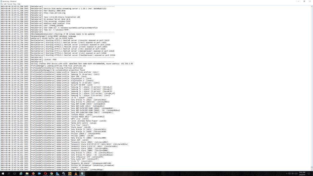

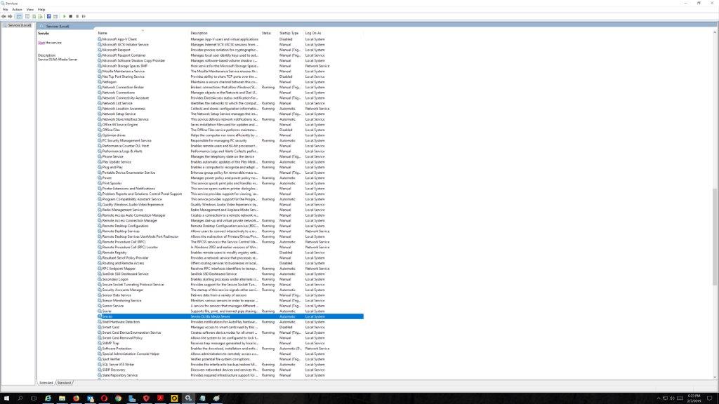

Hello I seem to be having the same problem with version 1.10.1.
I re-installed the software and it seems to work for a while and then the service stops. It manages to index a good portion of the specified library but then the service won't remain started. Not sure what is happening. Clicking Library Refresh stops the service. The only way the service works is when this is unchecked.

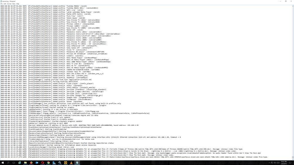

I have seen instances where one file will cause the indexer to fail.
Enable debug logging, force refresh and then, when it fails, examine the log. See if you can work out if it as always happening with one particular file or folder.
Remove the offending file/folder from the library for now. Try again (there may be more than one). Once you are able to successfully fully index your library we can look at any files that caused issues.
