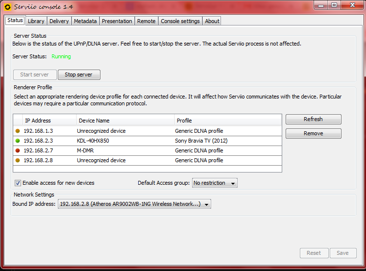

I have a SONY Bravia HX850. Serviio works just fine for me.
The problem is that when I add subtitles while streaming the movies to my SONY TV, the video shutters.
Without subtitles, all movies just work along fine.
Shuttering/ hanging of the videos while using subtitles is a major issue. What to do to solve this problem?
NX3
Posts: 578
Post Mon Dec 30, 2013 9:02 am
Re: SONY BRAVIA KDL40-HX850 subtitles
With subtitle enabled serviio is transcoding the video to burn them into the stream. The stuttering is your server struggling to keep up. A faster cpu would help or a media box...
