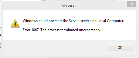

3) serviio service was not started, trying to start it got the #2 attachment Windows error 1067;

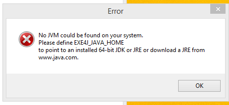

message #1
Error
No JVM could be found on your system.
Please define EXE4J_JAVA_HOME
to point to an installed 64-bit JDK or JRE or download a JRE from http://www.java.com.
message #2
Services
Windows could not start the Serviio service on Local Computer.
Error 1067: The process terminated unexpectedly.

Do users know that you can often get the system message from the graphic?
Put the cursor in the graphic. Click to be sure it has focus. Do cntl-C. Open Notepad and paste ...
Error
the error message is often there and easily pasted search boxes and include in posts (for searches).

Yes, of course, you have to un-install Java 64 bit and reinstall running a downloaded installer from java.com.
Through it all the serviio service disappeared or became unfunctional. You should expect to have to then reload Serviio.
Of course if you need a non-local account in Seviio service properties 'logon' set that, reboot again.
In Serviio console on the library tab tap 'show status' button. If you do not see real filenames (or otherwise detect files aren't being updated) try to see if just re-inputing the user logon password in the services properties (reboot) fixes it - something there reset on me.

Here is the fix go to computer open go to x86 folder open and find java open folder copy JRE6 folder. Go back to computer and open program files folder and open java folder paste JRE6 folder. Click and open serviio and presto back in business. This will fix the issue in windows 7 64 bit once you have auto updated Java.
