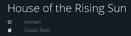

I have many differences between the tag info shown by MediaBrowser and the real mp3 tags of the file.
Here's an example of MediaBrowser:
These are the correct ID3v2 tags:
As you can see, both genre and artist are wrong. It seems as if MediaBrowser is still using the info from the past. The tags have been updated and the Serviio library was refreshed.

Post Mon Sep 21, 2015 3:51 pm
Re: MediaBrowser shows wrong tags
Are you sure there are only the 2.4 tag data? No other tags present at the same time?
What happens if you remove and re-add the file to the library?

Post Mon Sep 21, 2015 9:14 pm
Hi zip,
yes, only 2.4 tag data. I did what you asked for, I removed the file, waited for Serviio to refresh the library, added it again, waited for the next refresh (this is one hour in my configuration) and voilà, the tags were correct. There seems to be a bug in the library update process. Would be great if that could be fixed in the next build. Is there a release date already?
FYI, i added "serviio.forceLibraryPoller=true" to the serviio start script b/c the default update mechanism didn't work at all.
I will delete the library folder and let it rebuild from scratch over night. This seems to be the only way to get out of this mess (I updated a lot of files during the last few days).
Anyway, besides a few annoying bugs, the MediaBrowser is great. I especially like the search function, which is super fast. :)

Post Tue Sep 22, 2015 12:20 pm
Personally, I consider that song Classic Rock and not Pop. I think it half right originally! :lol:

Post Tue Sep 22, 2015 3:58 pm
atc98092 wrote:Personally, I consider that song Classic Rock and not Pop. I think it half right originally! :lol:
For the purpose of a better overview, I deleted many genres, so I only had the choice between pop and rock. ;)

Post Tue Sep 22, 2015 10:39 pm
Do you have 'Search for updates to shared files' checkbox selected? The red box here: http://wiki.serviio.org/doku.php?id=ser ... _explained

Post Wed Sep 23, 2015 3:32 pm
Yes, it's selected. I reproduced this problem for v1.4.1.2, it's the same. No tags get updated unless you remove/add the file. Maybe just renaming or moving the file works also, but I haven't tested that. What does get updated is the cover art!

Post Thu Sep 24, 2015 6:37 pm
So if you enable detailed log and make the update, do you see in the log some entries about the file being updated and metadata reextracted? Also, does the file's lastmodified date change once you update the tags?

Post Fri Sep 25, 2015 1:36 pm
The detailed log doesn't show anything. The file's lastmodified date doesn't change after updating the tags.

Post Mon Sep 28, 2015 11:31 am
Sheriff Hobbes wrote:The detailed log doesn't show anything. The file's lastmodified date doesn't change after updating the tags.
Ah, that would be why. Serviio doesn't know the file has changed if the date doesn't change. Perhaps you can try a different tag editor..?

Post Tue Sep 29, 2015 9:56 am
I can confirm that after changing the lastmodified date ("touch <file name>") the tags get updated!
However, why does Serviio update the cover art w/o changing the lastmodified date? Maybe because the file size changes? It changes on cover change, not on tag change.

Post Wed Sep 30, 2015 7:56 am
Maybe the cover is in an external file, not inside the audio file itself?

Post Fri Oct 02, 2015 4:57 am
No, it's embedded, that's why the file size changes. You can delete the external image after adding it to the MP3 and it will still be displayed.
