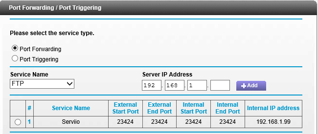

I'm assuming that you have set up your router to assign a static IP address for the computer that you have Serviio installed on. In my case that is 192.168.1.99
In the port forwarding section of my router I have a rule set as shown in the attachment.
What kind of model of router do you have?

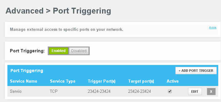

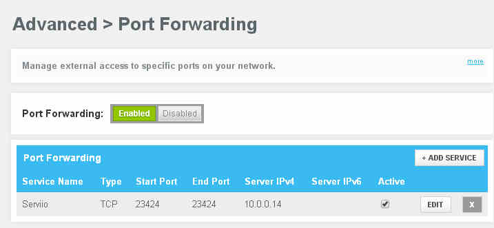

Here's my current setup:
This is what I initially had:
After seeing your image, I added the following (after adding this, should I have reset the modem/router?):

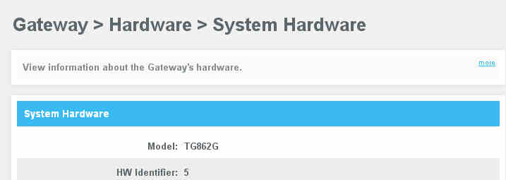

And here is a little info on the device, which is an Xfinity combo cable modem/router:
I hope this helps.

I don't use port triggering in my router so I have no settings to compare. I only use Port forwarding which I believe is the correct set up for Serviio.
What happens if you clear the port triggering settings in your router and try to access Serviio remotely?
I assume that 10.0.0.14 is the fixed IP address for the computer that is running Serviio. Have you checked at the computer that it's internal IP address is actually set to that? (If it's Windows run IPCONFIG from a command prompt).
