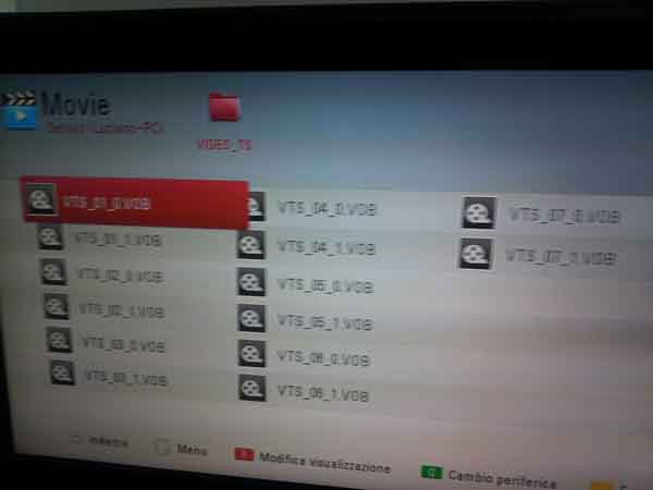

Hi, I bought Serviio pro and version 1.6 installed. through the reader I read the library but I have problems with the dvd structure. the previous version I saw entire hotel now with version 1.6 I see only the first two of each group vob, for example see vts_01_0.vob, vts_01_1.vob, vts_02_0.vob, vts_02_1.vobb etc ... I can not see where the part containing the title track, for example vts_01_3 etc. How can I do?

yes sure, stacking is enabled but I see two files for each vob as explained above

Can you post the whole directory listing?

I attach as required directory listing that you see from my lg bp620, compared to a player dlna seen on my phone do not see the file properties

but not this, which also shows up as two entries, pt1 and pt2, in the /Home/Video/Movies path:
[glz@midgard] /mnt/media/media/movies/Stalker (1979)% ls -lh
total 2869581
drwxr-xr-x   2 glz  glz    20B Feb 29 15:35 ./
drwxr-xr-x  67 glz  glz    72B Feb 29 14:18 ../
-rw-r--r--   1 glz  glz   1.4G Jun 15  2013 Stalker (1979) pt1.m4v
-rw-r--r--   1 glz  glz   1.3G Jun 15  2013 Stalker (1979) pt2.m4v
-rw-r--r--   1 glz  glz   3.4k Jun 15  2013 Stalker (1979).nfo
-rw-rw-rw-   1 glz  glz   152k Jun 15  2013 Stalker (1979).tbn
-rw-r--r--   1 glz  glz   3.3k Sep  6  2013 movie.nfo
-rw-r--r--   1 glz  glz   7.0k Aug  6  2015 movie.xml
I see no structural difference to why Yojimbo is seen as a stack and Stalker is not. Only difference is that Stalker was added in Servo 1.5.
Any ideas?
