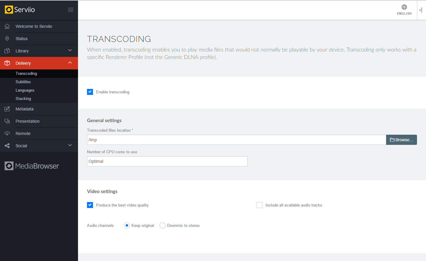

Thanks for the reply, but this is what the delivery->transcoding menu looks like for me right now:

The setting you seek is on the "Remote" tab :)
