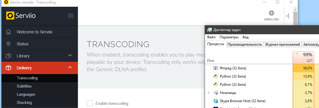

When I've updated my 1.6.1 serviio installation to 1.9 I've had some bug. When I add local folders to the library after few minutes service stops responding.
So here are logs with log level = DEBUG
It seems that transcoding not disabling properly. As you can see it's disabled but ffmpeg transcoding somthing

I assume it's ffmpeg refreshing all your files in the library. Wait for it to finish. The log looks normal.
