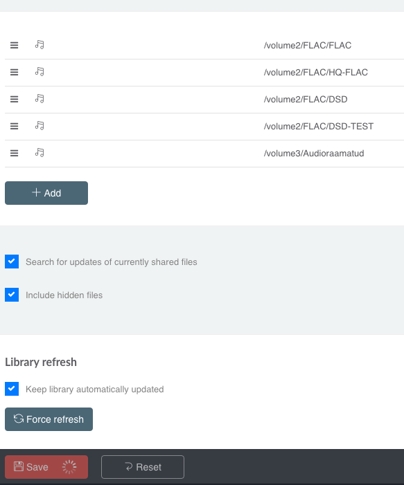

I have Synology DS916+ and Serviio 1.9 .
I shared four folders succesfully,but when I share next folder,then I click SAVE button and in button will square rounding and nothing happens more.I have probed another folder too,same problem.Please help!

This is typically a permissions issue between Serviio and your NAS. Remember that Serviio does not run with your user permissions, but instead uses a built in service on your computher that has limited network privileges. The folders on your NAS that successfully connected most likely have different permissions set compared to the ones that won't connect. The simplest fix is to change the account that Serviio uses to run on the computer to the same user account you use to log in. Then Serviio can access everything you can.

Thanks! Working fine.
