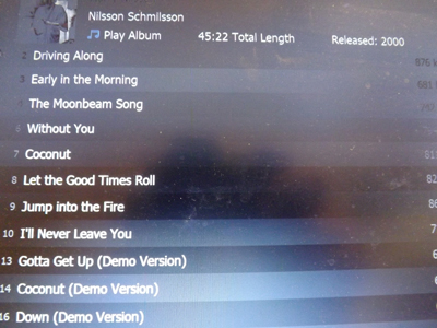

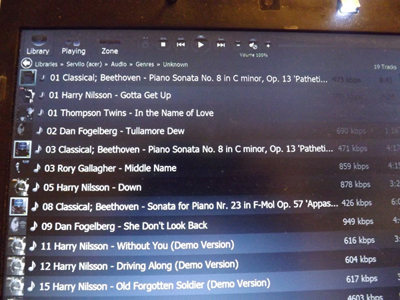

Example Nilsson tracks 1, 5, 11,12 and 15 are in unknown genres AND are all missing from indexes (see attachments).
Added to BitBucket - #1043: Indexing of Audio Genres and missing album tracks
Artist/Album tracks with missing items
Genres Uknown

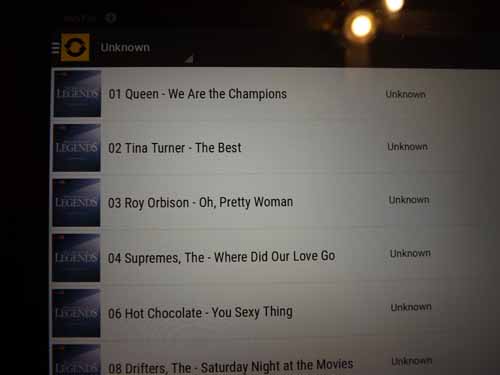

I enclose log files that trapped items going into the genres/unknown category.
I amalgamated three folders of "The Very Best of Legends" (Disc 1, Disc 2, Disc 3) into a single album folder.
This involved changes to the metadata for album name, disc no , track names and track numbers.
A number of the files (13 of 65) went into genres/unknown.
The 13 do not appear in the Album/Artist indexes.
The meta data is correct.
Serviio created 5 logs (of 501k) which are zipped.
genres/unknown files

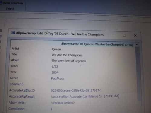

metadata

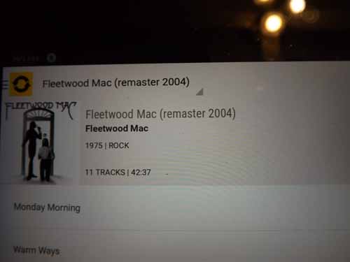

I have discovered a different audio metadata indexing issue. It is covered by the same logs I attached.
I changed an album title from "Fleetwood Mac (remaster 2004)" to "Fleetwood Mac (Remaster 2004)".
It has not taken effect despite Force Refresh.
I then tried altering to "Fleetwood Mac (2004 Remaster 2004)" and then back to "Fleetwood Mac (Remaster 2004)" all with no effect.
It occurred to me I had also altered the album folder name to "Fleetwood Mac (Remaster 2004)" at the same time I made the initial change - could this be a factor.
UPDATE: I removed the folder from the media library and then re-added it (without metadata change) and it now indexed perfectly OK.
album name change not working

Yes, this file indexes correctly.
Is it the same version that indexed with Unknown genre? I wonder if it can be something to do with the metadata tool and how it stores data. Maybe it makes the updates in phases, Serviio detect the initial step (with missing data), and then ignores the other phases (when it fill the metadata back in) ... totally guessing though.

zip wrote:Yes, this file indexes correctly.
It is the same file version that identified as unknown.
It did clear when I reran later as did the other 12 files.
The metadata tool is dBpoweramp Edit ID Tag (in this case Multiple Files version).
I was running it over the network to the library files so your theory about timing and phases may be correct.
