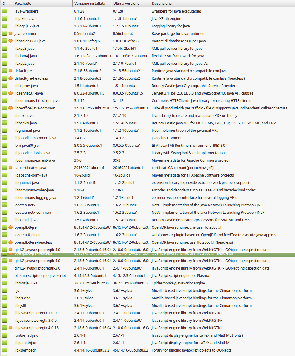

These are all the Java packages installed on my PC:

zip wrote:you should be able to get OpenJDK Java, rather than the IBM one.
I tried only with the Openjdk-9-jre in a virtual machine with the same system but nothing :-(
jk50
Posts: 57
Joined: Mon Jan 09, 2012 9:53 am
Post Wed Mar 07, 2018 10:18 am
Re: Problem x509
Looking at your earlier attachment ,you have both IBM java and Openjdk 8 java installed. Your system was defaulting to IBM java.
I don't know what you your trying in the virtual machine ,but you don't want Openjdk-9-jre you need Openjdk-8-jre .
