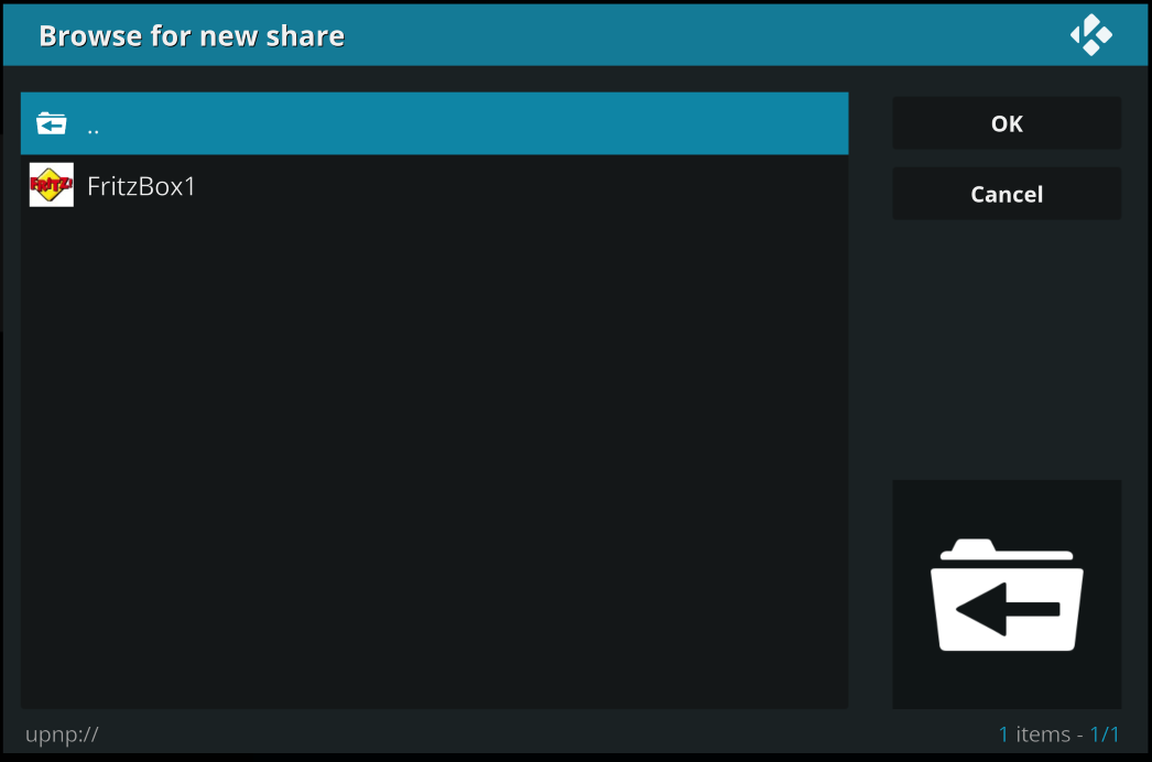

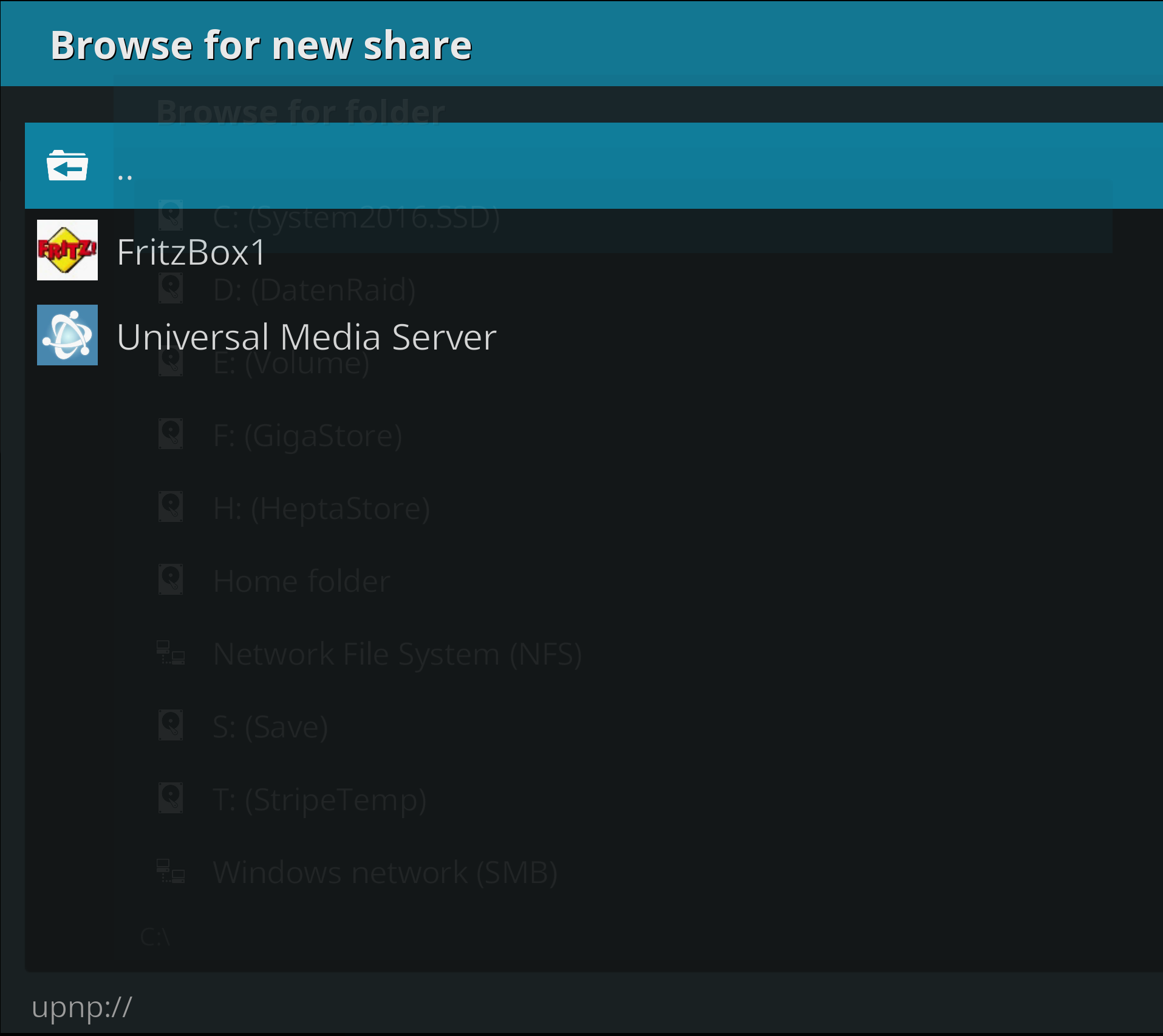

I am using Serviio v1.9 on a Windows Server 2016 until about a week ago very successfully. But suddenly Serviio doesn't appear as UPnP server on my various devices (Internet Radio, Samsung TV, VLC player). Access via the WWW frontend, on the other hand, continues to function without any problems for Serviio. I hadn't touched Serviio in months. Accordingly, I don't think I've changed anything in the Serviio configuration here. Interestingly, restarting Windows Server 2016 will cause Serviio to become partially visible as UPnP server for a few hours on the network. But after a while the UPnP server disappears from my list of devices. What I've tried so far:
1.) I uninstalled and reinstalled Serviio. But that did not bring success.
2.) If I turn off the firewall of Windows Server 2016, however, I can't see the Serviio UPnP server either. From this I deduce that the firewall is not the reason why my UPnP devices don't see Serviio anymore.
3.) Two different network cards are attached to the physical server. Here I have tried the option to let Serviio decide automatically, have one network card and the other network card bound to Serviio. Even without success.
Meanwhile, I'm running out of ideas about what else to try. On the Windows Server 2016 I haven't made any significant changes lately. What I can't rule out, however, is that either Microsoft has been running an update lately. Or that Oracel added a new Java version to the system.
Anybody else have an idea? Or do I have to disconnect from Serviio as UPnP server again? Previously I had been running Twonky as UPnP server for many years and was very happy to have discovered Serviio. But apparently every beautiful relationship comes to an end at some point....

Hallo,
something I have forgotten to mention: after reinstallation and starting up Serviio the software reports immerdiately the following devices when I check under "status!:
192.168.178.1 Unrecognized device Generic DLNA profile Bearbeiten
192.168.178.24 Roku SoundBridge M400 Generic DLNA profile Bearbeiten
192.168.178.33 Unrecognized device Generic DLNA profile Bearbeiten
192.168.178.75 Unrecognized device Generic DLNA profile Bearbeiten
192.168.178.91 UE55JU6400 Samsung TV / player (J-...
In other words: I seams there is some kind of UPnP comunication in my LAN. However, the various devices to not see the Serviio UPnP server in the net. Strange. Any ideas?

Same Problem here:
- Windows Server 2016
- Serviio > 1.7
- Firewall turned off
- WebInterface & ServiioGo are working
- DLNA-Server is not found on all Devices (Kodi, Android, Sony BR, FritzPhone...)
- DLNA-Server did work on 1.6. or 1.7.

Thanks for your help!
UPNP-Scan Kodi (Same Computer as Serviio-Server): Does not show Serviio (reclick-s)

I changed Serviio to a second Network-Card (free of Hyper-V) + Upgrade to 1.9.1. Same result...

Post Tue Feb 20, 2018 12:31 pm
Re: UPnP interface is gone while Web interface still is visi
Hi!
Thanks for your time & help.
Turn on debug log and see if there's anything more when this happens.
Please find attached the debug-log, I removed all PlaylistMaintainerWorker|MediaItemDAOImpl|PlaylistDAOImpl|PlaylistParser|SubtitleFileIndexer|MediaFileIndexer|PlaylistFileIndexer|PersonDAOImpl|VideoDAOImpl|CoverImageDAOImpl|FolderDAOImpl|RepositoryDAOImpl|GenreDAOImpl|ImageUtils|VideoService|OpenSubtitlesService|MetadataDescriptorDAOImpl|TheMovieDBTvSourceAdaptor|OnlineVideoSourcesMetadataExtractor|OnlineRepositoryDAOImpl|LibraryHelper|TheTVDBv2SourceAdaptor|MusicAlbumDAOImpl|AudioService|ExternalIPRetriever|PortMappingChecker - lines
Did something recently change anywhere on your network?
Nope - the upgrade to Serviio 1.8./1.9. is the only change
Do you have IMGP settings on your router - have they changed?
No IMGP-Settings.
I installed the "Universal Media Server" on the same Computer: All Devices can see the "Universal Media Server" via upnp but do not see the Serviio-UPNP. I think Hyper-V, Router and Network are not the cause....
debuglog_clean.zip
(84.44 KiB) Downloaded 775 times
pc5dczc_2018-02-20 12_45_22-Kodi.png (157.23 KiB) Viewed 26179 times
