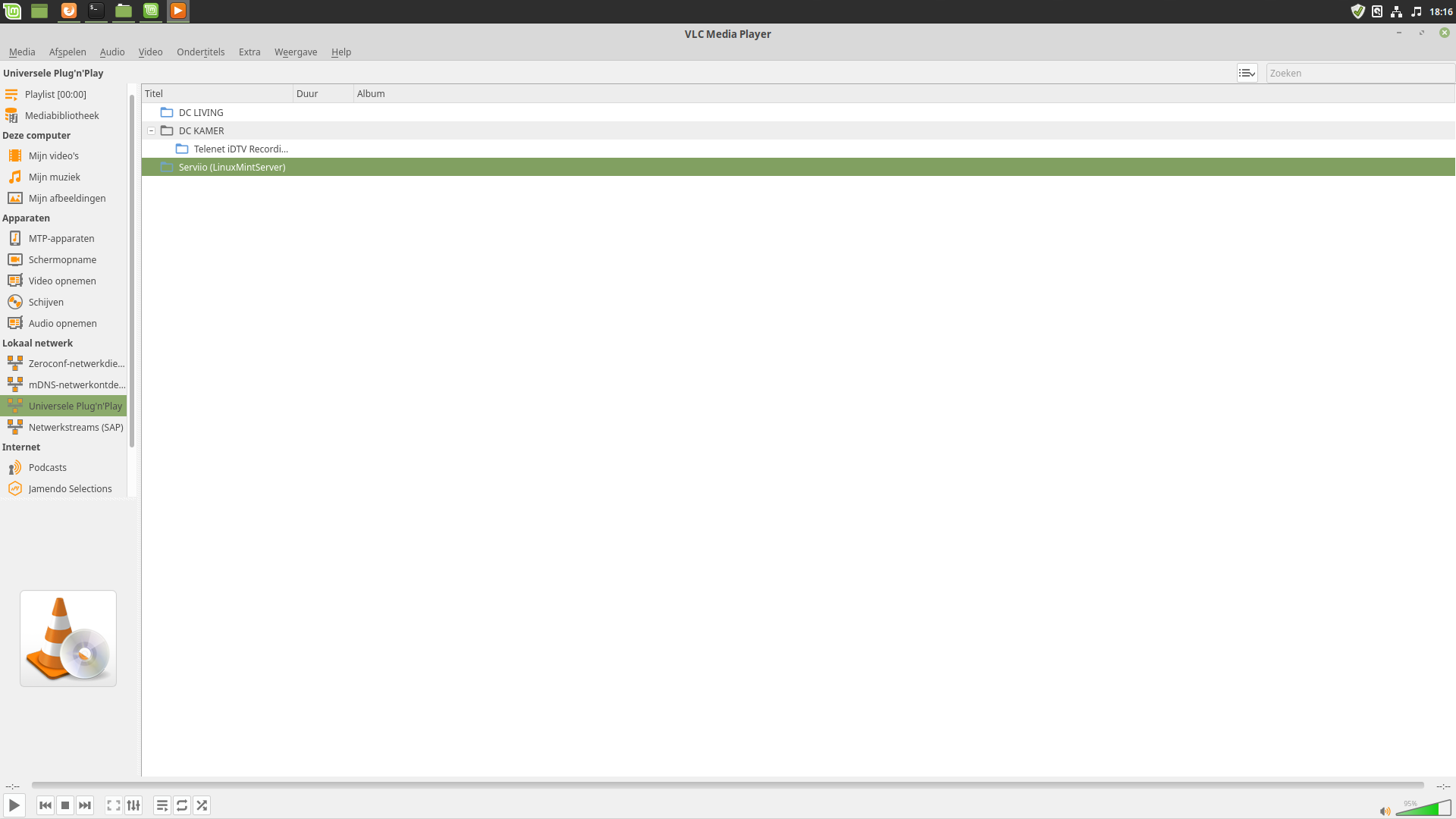

That is what i see on the vlc player whitch is the same pc
Schermafdruk van 2019-03-01 18-16-19.png (91.85 KiB) Viewed 15528 times

Post Fri Mar 01, 2019 8:39 pm
Re: many problems with serviio settings en installing linux
I'm glad you found the log. With debug logging enabled, the log is being split into multiple files. The one you attached is missing the initial Serviio startup. I can see that it is recognizing your media, I believe the IP address of your Serviio computer is 192.168.1.128, and I think I see where you are accessing Serviio via VLC, although that might be MediaBrowser as well. What is puzzling me is I see the profile 'DirecTV HD-DVR' being used for your computer IP, and I don't understand why that profile is being used. VLC should just use the generic profile, as it can play virtually anything. I just fired up VLC on my computer and it sees all three of my Serviio installations on my network, including my Mint box, and is displaying the available media. Unfortunately, I can find nothing in your log that indicates a problem. Unfortunately, I believe I've hit my limit on what I can help with. Zip, the Serviio developer, will likely have to look this over now. I just can't find any reason your TV and especially VLC can't see your media.
