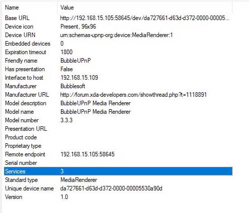

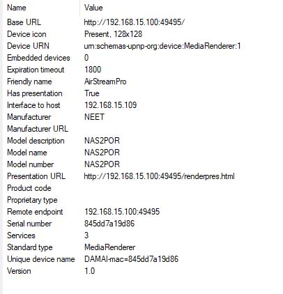

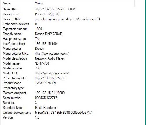

I did download UPnP tools and Device spy (as you suggested).
The results for three devices are attached.
I am trying to do two things:-
1. Initially I was trying the ensure that my "Generic HD Profile" in my user-profiles.xml file is used by Kindle 7 HDX which runs BubbleUpnP and does not have a fixed IP.
Hence my original suggestion of an alternative default profile.
The only change in the generic profile was ThumbNail HD not DLNA for quality artwork.
2. Additionally I added an audio transcode in <OnlineTranscoding> to detect ogg files (which would not play) and match them with LPCM which works fine.
Hence Denon and AirstreamPro devices.
My last <Detection> attempt that failed was (I tried several other options)
<Detection>
<UPnPSearch>
<Manufacturer>Bubblesoft</Manufacturer>
<Manufacturer>Denon</Manufacturer>
<Manufacturer>NEET</Manufacturer>
</UPnPSearch>
</Detection>
It validates with one <Manufacturer> line but not sure yet if it "works".
Maybe I need to create 3 individual profiles?
Neet AirstreamPro
Denon DNP-730AE streamer
BubbleUPnP on Kindle 7
Paul C

Post Tue Oct 22, 2019 5:17 am
Re: Creating a user-profiles.xml file
Must admit Ive never tried a match based just on Manufaturer or Model Number. Have you tried using Freindly Name (which I've had success with).
To add multiple Freindly Name's to the one profile you will need to use a Regular Expression using its "OR" capability and grouping capabilities - something like (remembering I'm a novice at Regular Expressions):
    <FriendlyName>(Air Stream Pro)|(Dennon DNP-730AE)I(Bubble UPnP)</FriendlyName>
might work, you'd have to play with it. Remember to restart your server after changing profiles.
ps. <ModelNumber> not <Model Number>
