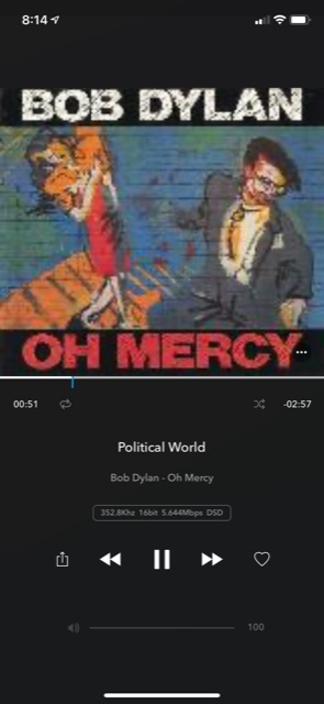

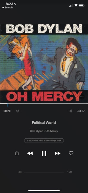

Post Thu Jul 09, 2020 4:15 pm
Re: Does Serviio downgrade DSD (DSF) playback of audio?
Just to provide some visuals to my problem. You will notice using the same app to my Auralic streamer, I am seeing a lower sample rate representation streaming via Serviio versus MinimServer. The other thing I am noticing, is that the album artwork is of a lower quality via Serviio compared with other UPnP/DLNA streaming tools.
I am not sure whether these issues can be resolved but if so, I would love to know where I can make any adjustments/changes to remediate.
Thanks in advance for any help/guidance, as this is not obvious to me within the console. Thanks!
Serviio Streaming DSD
Serviio DSD.jpg (40.16 KiB) Viewed 12814 times
MinimServer Streaming DSD
MinimServer DSD.jpg (48.25 KiB) Viewed 12814 times
