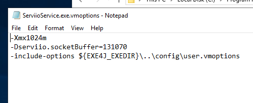

So after this I was at a loss and started poking around, Yes, this was my first mistake!! I should have stopped and came to the forum.... Anyways, I did some more poking around on how user.vmoptions is applied to Serviio. I learned this user.vmoptions is invoked from the Serviioservice.exe.vmoptions. A couple of other references to placing user options in this location instead of the user.vmoptions location. After going back and looking these were older 2012 - 2015 posts so I am assuming this user.vmoptions implementation has been since then (just guessing). So anyways, I placed the options in this location:
3
I restarted the service and then things deteriorated quickly. I attempting to access serviio and it will show up on the streaming device. I access Serviio and the main folder shows up for a moment and then closes back to the home screen of the TV. I went to the log files and now found the option was being applied, but now it also appeared to go into errorsville. I removed the changes taking the option out of the exe.vmoptions and placing it back in the user.vmoptions. It won't let me place the log showing the errors (there might be a work around but this is my first post). Anyways, I have the error log showing the option is applied, but then there are many errors.

I don't believe the Includes line is needed in the main vmoptions file for Serviio to use the user.vmoptions file. I don't have it in mine.
To get back to "normal", change the main vmoptions file back to only include the Xmx line, and remove the user.vmoptions file completely. That should get you back to as installed.

On the user.vmoptions and the serviioservice.exe.vmoptions I returned both of those to default. I’ve restarted the service and even rebooted, but it still won’t take me back to the stock setup. Any ideas on unbreaking my machine?
