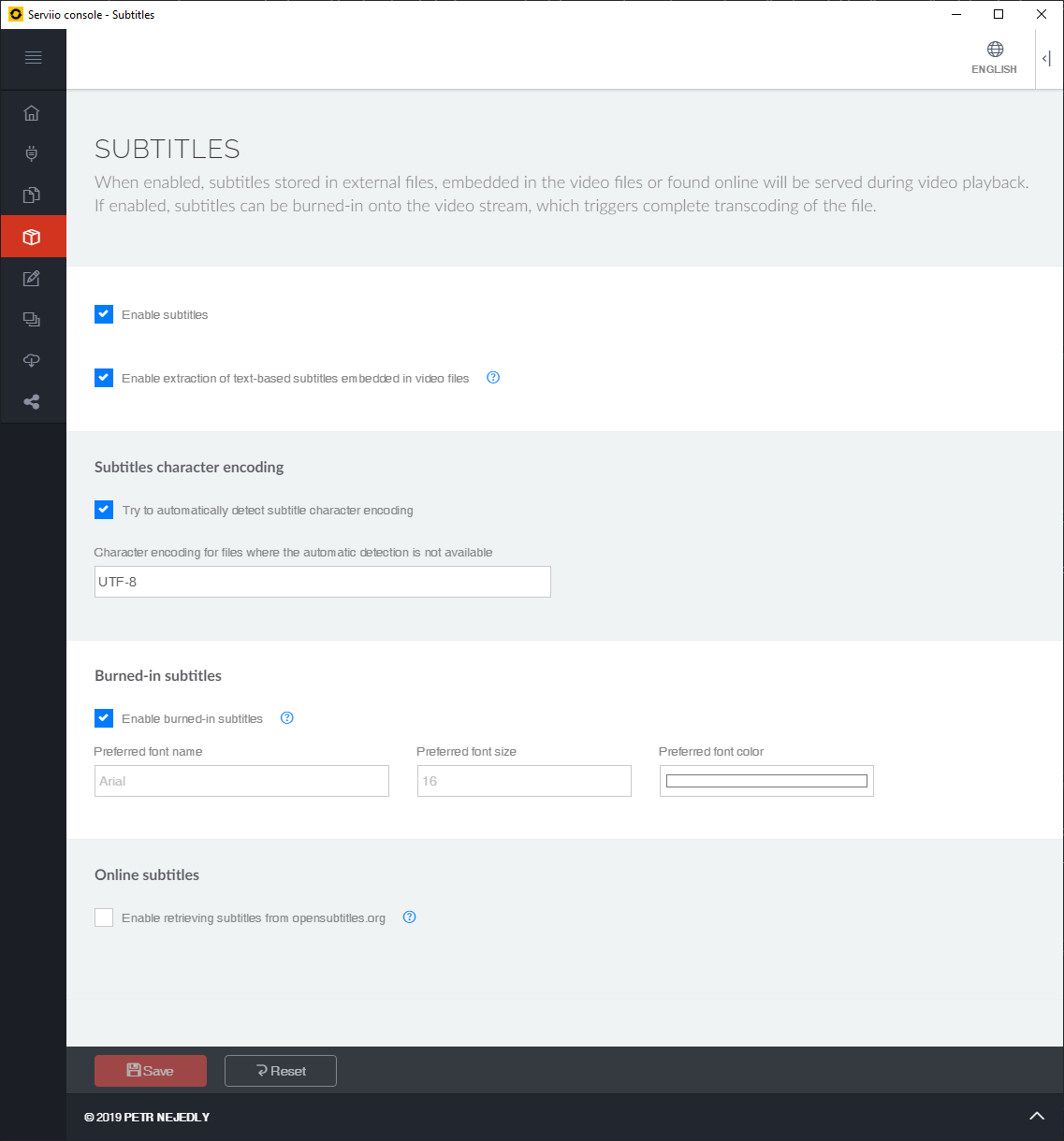

Also please attach a screenshot of your Subtitles Serviio console tab.
