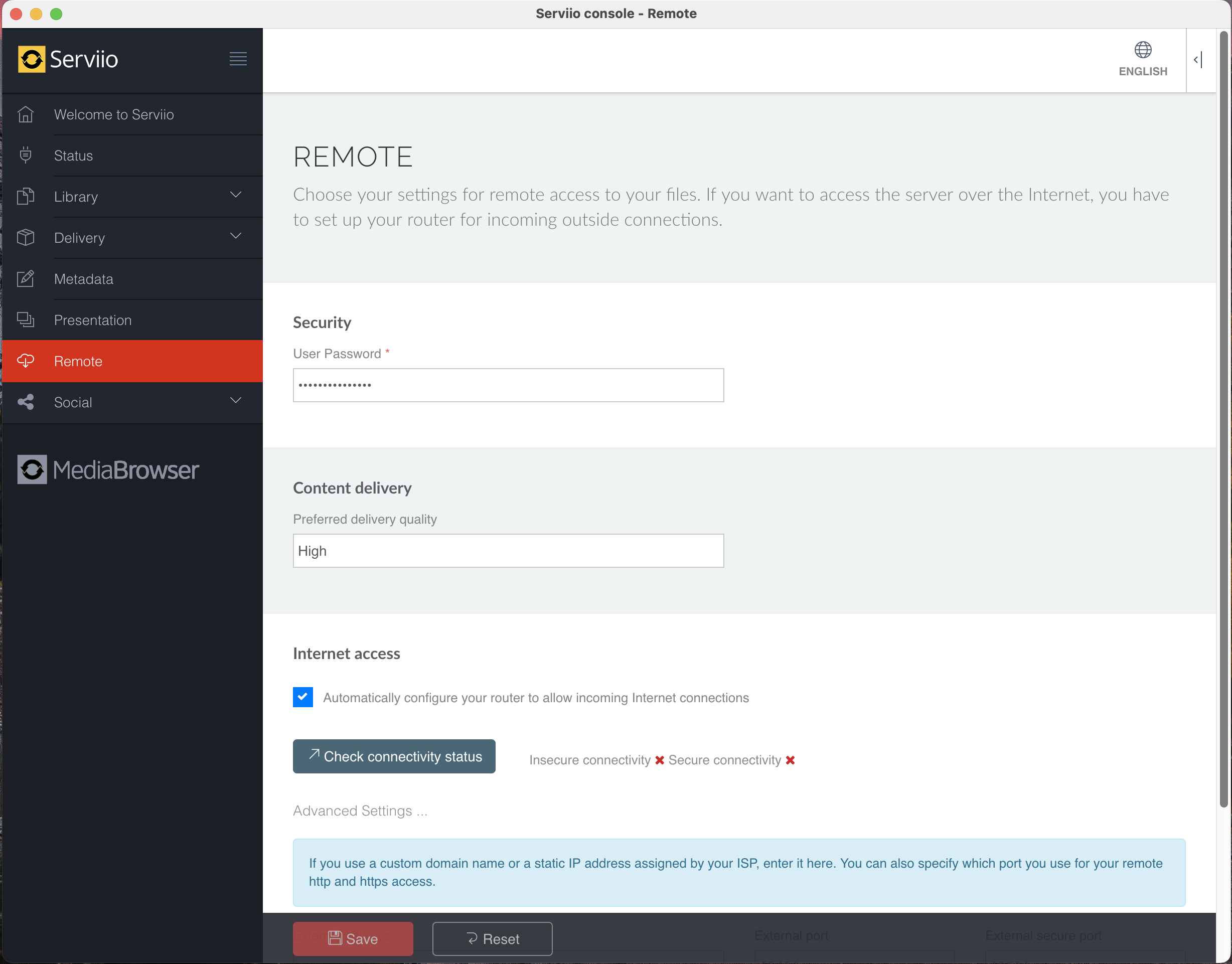

Can't access my remote server from outside the home wifi network.
Serviio is showing no connectivity.
Screenshot 2025-06-04 at 12.53.16.png (399.46 KiB) Viewed 22192 times
I've forwarded the port in my router settings. but still can't get connectivity via Serviio.

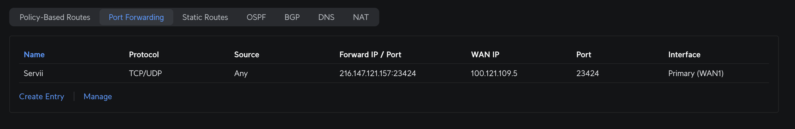

Screenshot 2025-06-04 at 13.03.04.png (90.53 KiB) Viewed 22192 times
Any help or ideas?

Post Sat Jun 14, 2025 4:22 pm
Re: Remote Server not accessible from outside home network
Are you trying to forward the port to an outside IP address?
None of the addresses in the listing are in a private IP block...

Good catch, I didn't notice that internal IP address. Your 216.147.121.x is in the public section of the approved IP addressing range. Home networks must use private IP address ranges. There are three groups of addresses that should be used in home networks. Using something in the public IP address range could cause routing issues.
There are three IPv4 private ranges for Class A, Class B and Class C IP address ranges. These private IP address ranges are given below:
Class A: 10.0.0.0 to 10.255.255.255 (16.777.216 IP addresses)
Class B: 172.16.0.0 to 172.31.255.255 (1.048.576 IP addresses)
Class C: 192.168.0.0 to 192.168.255.255 (65.536 IP addresses)
Most home networks use a Class C address. When you purchase a router, the most common range is 192.168.0.x or 192.168.1.x. Either one will support 254 separate devices on your network, and if you need more than that you can alter the NETMASK setting (normally 255.255.255.0) to enable more addresses. Networking discussions can get quite involved, so I won't spend more time here getting into details. But if your home network is not using IP addresses within one of the private ranges, you need to reconfigure your home network.

While using an internal IP Address range with addresses not in the "private" address space is unusual, it will most likely not yield to problems (obviously you will not be able to reach a web-server using these addresses), the issue you experience ist most likley CGNAT.
Starlink ist not a real internet access. You are located behind a large NAT network shared with many others. Incoming connections are not possible or very limited (read about NAT hole punching, or setup a small virtual Server with a real IPv4 Address, connect with VPN to this, then forward everything to your home from t here, or buy a service which gives you similar).
Or maybe there is an option that you can buy an IPv6 address space from starlink, then, use IPv6.

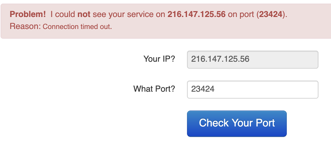

I tried the NoIP thing. can't get anything to recognize. I have no idea what I'm doing honestly. This all worked on my previous ISP and my 2010 iMac. Now with StarLink and my replacement 2019 iMac nothing works. Makes no sense to me.
The port is forwarded in my Ubiquiti router but when I check it via portchecktool.com it says it can't find it.
