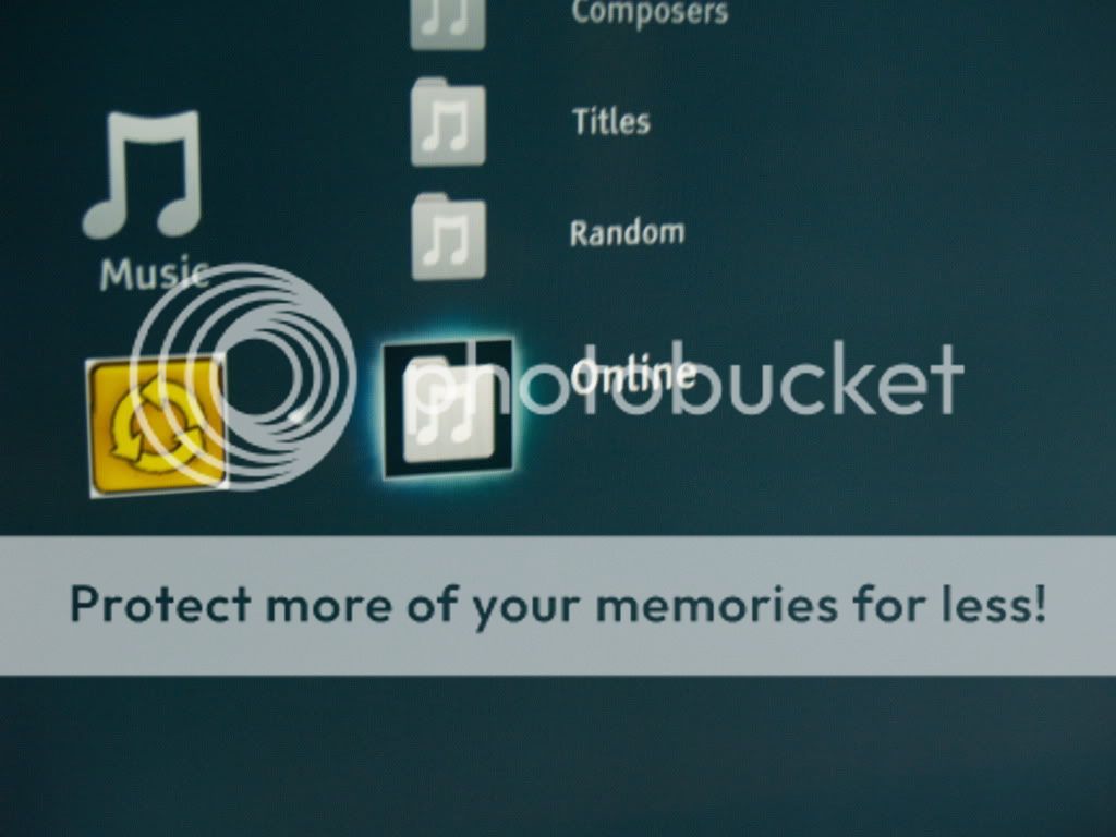

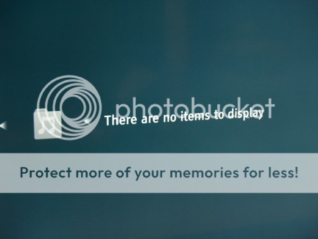

I've been using Serviio for many years and completely love it, mainly because I've never had a problem working with it. It does what it's supposed to do and gets the job done. I updated Serviio recently to the latest version and discovered the Online Sources section. I added a few different radio streams to the sources page but when I go to my tv nothing shows up. I have tried multiple URLs and still nothing. Perhaps it is something really simple that I am not doing right since everything else DOES work for me (local audio and video streams). I checked all of the links with ffmpeg and they all returned positive results so I am not sure where else to turn. Any assistance would be appreciated!
My TV: Sony Bravia KDL-55EX710
Online Sources I tried:

Thanks for replying jhb50. I've been working on it most of the day and have uploaded some pictures that might help. I am able to play these streams from my computer as well as my phone which leads me to believe it could be something with the tv. I have no idea though, just a thought. Please let me know if you would like more. I appreciate the help!

Well I reinstalled Serviio 0.6.2 as well as Java and it seemed to do the trick. I don't know why I didn't try this earlier but I appreciate the help anyway. Till next time!
