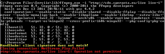

I'm trying to play this stream: rtmp://cdn.speranta.eu/live
it's not working and it gives an error.
Can anyone help me with this?
stream error.jpg (118.64 KiB) Viewed 24301 times
Post Sun Mar 25, 2012 6:40 pm
Re: RTMP streams that VLC reads but ffmpeg does not
It is not a complete rtmp url. Rtmp needs additional parameters that you need to sniff the source for.
Post Sun Mar 25, 2012 7:09 pm
jhb50 wrote: Rtmp needs additional parameters that you need to sniff the source for.
Not necessarily, but it might well be this case.
Post Sun Mar 25, 2012 8:54 pm
He needs playpath parameters following live. Any RTMP is incomplete and will not work without them. I think you were refering to the ability to have a single term rtmp command without separate parameter terms and yes you can but you need the playpath parameter value appended to the single term.
