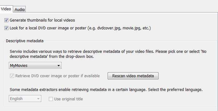

if you want serviio to use your mymovies metadata try to make the necessary changes in serviio console. does your console look like this:
if not change it and do a rescan hope this helps
