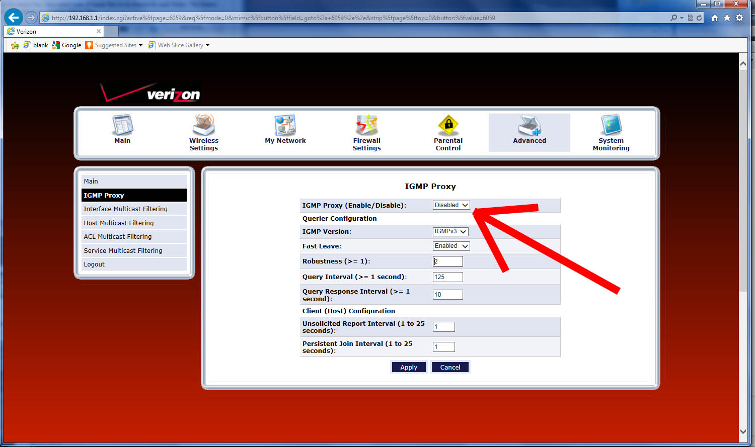

FYI... for anyone else after me having these same issues... I installed a competitors product. After doing so I still wasn't seeing their DLNA server showing on my Sony BDP S580 BluRay player.
* * * BUT * * *
That had a nice link on their site for things to look at if this was happening. And one of the items was to make sure IGMP snooping and IGMP Proxy related settings were turned off.
This turned out to be the culprit. I "Disabled" the IGMP-related settings/features in the router my Verizon FIOS service gave me and bada-bing she's back up and running.
Enclosed I'm attaching a PrtScr from the particular page within my Router settings/configuration to help visualize this for others.
