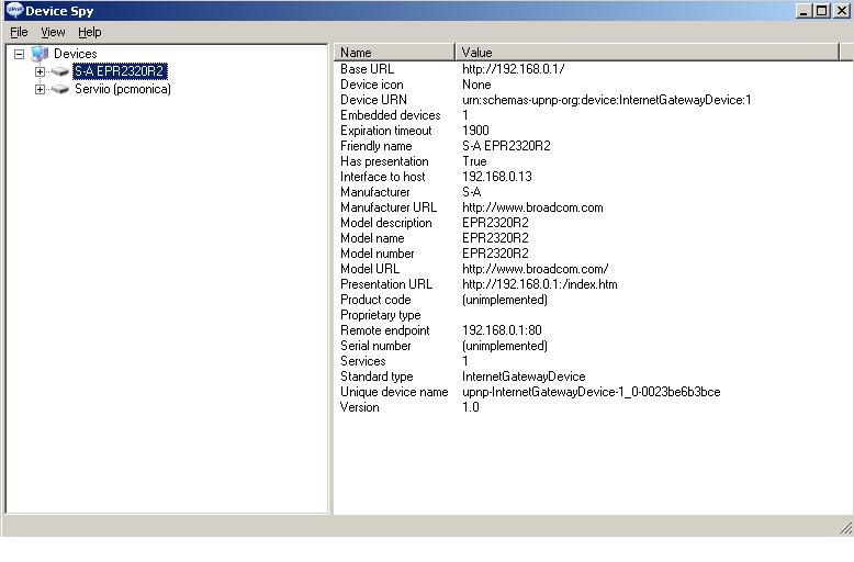

In Pc with serviio unplugged usb cable and connect wifi pendrive. Change IP to 192.168.0.13, open the ports in router and it not works.
Attach 2 images from Device Spy because I rarely bring up the ip 127.0.0.1.
Log with this information

there is something wrong with your network, as DeviceSpy cannot see your TV.
