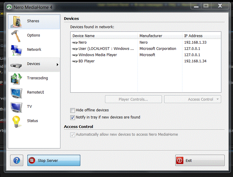

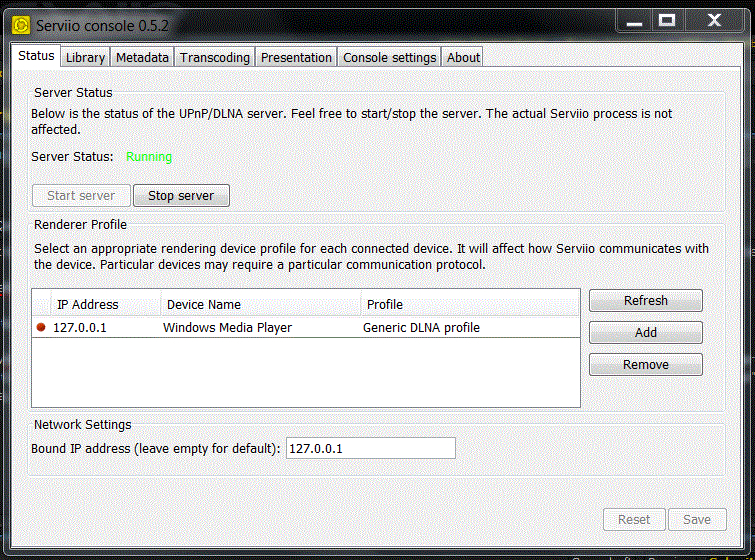

In the Serviio console status (server started) searched devices box I only see one other applicable server - WM. Occasionally I will get "Windows" media player to show after actually starting windows media player, but I don't think I am seeing the server. As I think I should, by comparing that box to the device dialog in a running Nero Mediahome server, I do not see: 1) my LG bluray player, 2) nero media home, widows media server.
I've tried bound (SAVE REFRESH) IP addresses of my server, 127.0.0.1, my network, 192.168.1.33. I've tried setting that to the IP of the bluray player, 192.168.1.33 and whatever my outer internet IP address is.
I've tried adding the LG bluray server Ip directly. It never shows as connected (green button).

You cannot use the 127.0.0.1 that is an internal IP address the same as local host. It cannot be addressed outside the computer. In the bound IP box, you need to put the IP address that is used to connect to your network. Like the 192.168.1.33 .

This could be caused by you having multiple IP addresses on the machine and Serviio binding to a wrong one. Insert IP address of the machine running Serviio into 'Bound IP address' field in Network Settings section in the console or pass system variable serviio.boundAddr including the IP address when starting the server.
Also make sure that TCP port 8895 and UDP 1900 are open in your firewall.
