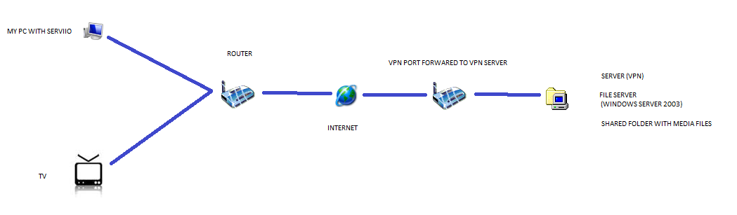

Me and my friends are trying to make one database for media. (Lets say shared folder ower internet.) At the moment we hawe everyone own separated database at home. The plan is to place the database to our company server. It has 30mb up and 30mb down speed. (Is it enought speed? I hope it is...) I created from my home pc VPN connection to company server. I shared one folder out from server with media and located thad folder with Serviio. Everything is went well.... i turned on TV and also i able to see that folder but its empty :( Cant see the folder context. What can be the problem? Any solutions? Allso i installed later to company server serviio and i tryed to locate my tv through VPN but no sucsess....
Sry for my bad English :)
Connection map

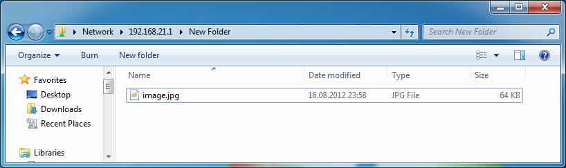

What you mean share the media? I can share out only the folder and files from folder will be shared. I cant share out just one media file. (see picture 1)

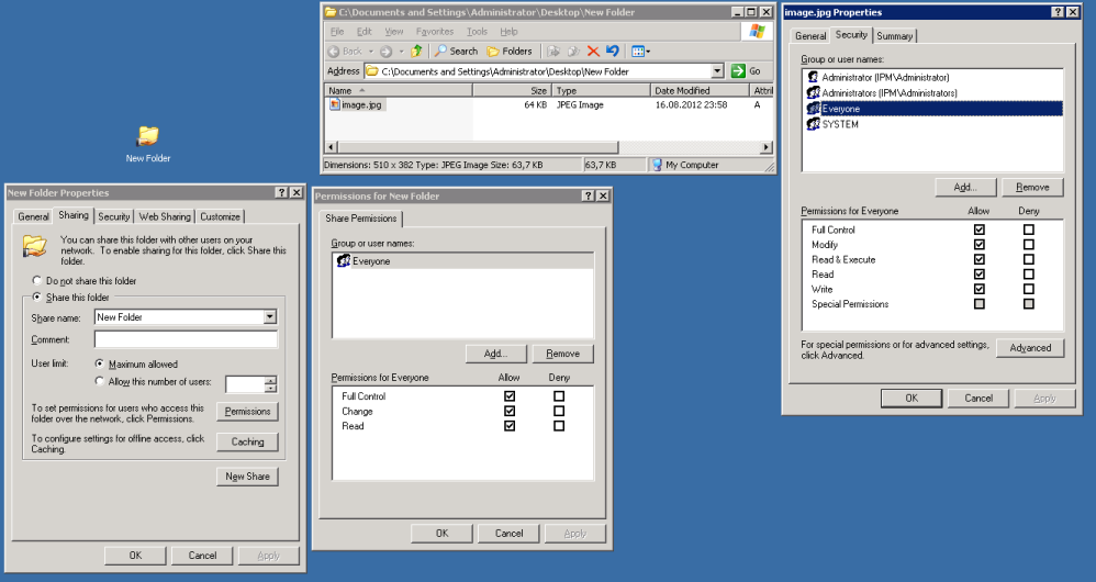

Seems i can access to the network folder. (see picture 2)

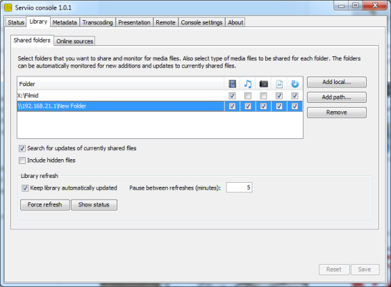

This way i added the network folder. (see picture 3) I started from button "Add local..." and then from desktop i used shortcut to network folder.(to locate the folder). This wai i see at least te folder but no context from folder.
I tryed as well form "Add Path...." but after that Serviio is stopped responding and after restart didnt worked any more... Probably i have to reinstall it.
(picture 1)
share propertis.png (94.65 KiB) Viewed 30539 times
(picture 2)
User accsess.png (56.66 KiB) Viewed 30539 times
(picture 3)
Locate folder.png (73.03 KiB) Viewed 30539 times

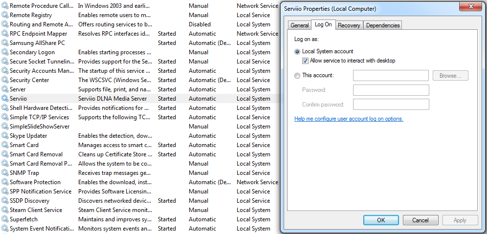

Probably it will not work if i make accounts with same names. its not enought... Server where shared folder located is domain server. Then probably i have to setup my home pc to that domain by somehow. But is it possible to run Serviio service under some other account? See picture...
serviio service.png (77.28 KiB) Viewed 30524 times

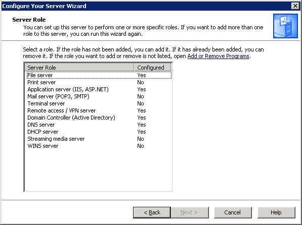

Here are the server configuration. Yes, its a DC server. It has also configured as web server and ftp.

Auto mapping of users is not an option, if this is the DC. In that case, you have two options.
1. Run serviio service as any other local user account except local system account
or
2. Map a remote server folder as an domain user [domain\username] from local system in a local user profile and user same user as service account
NPuser

Seems those options don't work. I created same user to my home pc like i have it in server. I runned Serviio service under that account (not local any more). I created Map Network drive when vpn is connected and entered username and pass for server. Actually for vpn and login in server i have one and the same account. It must be enought just from vpn connection to see files and runn everything normaly. Then located from Serviio console the drive and same issue. Just empty folder like usually :mrgreen: Any more ideas? I just need to create one media database to workplace and then over internet to see it.

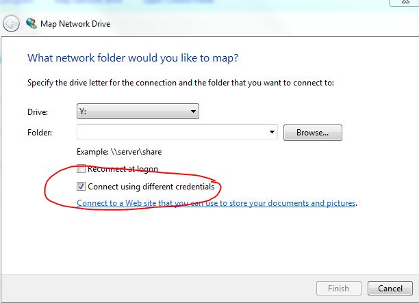

Any new ideas how to solve my problem? I created that map network drive... If i am opening it from my home pc then i can do in folder anything... read, write, create and delete. Full control. Located that map to serviio and no accsess rights. Serviio service is still running under localhost. I also used the domain admin account to be sure that i have full access to everything. Also established the vpn with that user. Local pc is also running under admin account. No other accounts in pc. btw... when i am locating that map drive folder, then i have to use DC server local IP address because with domain name it cant find the server from my home. Serviio log is still the same
2012-08-21 23:52:17,642 WARN [LibraryAdditionsCheckerThread] Folder 'Y:\' is either not an existing directory or cannot be read due to access rights

The point is if you will make vpn connection to server with domain controller then you are using the domain user account to login. Also after that you have to create "Map Network Drive" and must use for connection again domain user account. After that is possible to use that map drive in windows explorer with full rights. But Serviio service still cant access to Map Network Drive. Its running under local system and dont have premissions to that folder. From service Log On tab you cant enter the username with what to run service. You cant add there the domain user, its only allowed to add local user accounts. Because local pc cant find the domain ower vpn. Question is how to run the serviio service with domain user account? How to grant to Serviio service access to Map Network Drive? Seems its inpossible. Other solution is to runn serviio as simple program without running service. Then it can access to folder. Its not solution to create same username to local pc like it is on the domain server.
