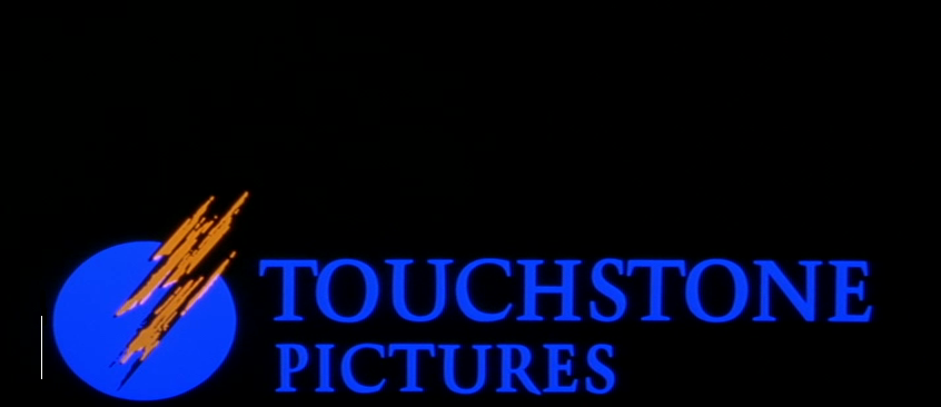

I realized why I was loosing some many pixels left and right on the Bravia - I had Screen->Display Area set to -1, putting it back to normal gave me more pixels but not the full amount.
Touchstone pictures banner from start of 13th Warrior. White line shows the where the Bravia crops it off - about 30 something pixels. Happens in both orig and transcoded. Edge of the circle is 48 Pixels from edge in the snapshot
Sony Bravia KDL-32V5500 | Panasonic Viera TH-P42U30Z | Panasonic DMP-BD75 | Windows 7 |
