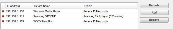

OK, I just tested FLV1/VP6F and they are working on my Samsung but not the WDTV Live, and such I'm assuming "Transcoding" of FLV is already in Samsung profile but not in WDTV profile due to "Generic", right?
