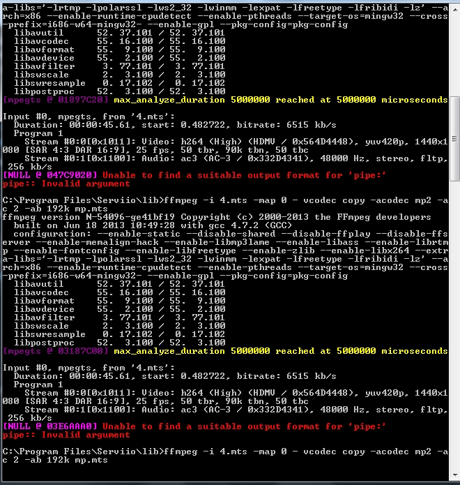

Post Tue Jan 14, 2014 12:58 pm
Re: Samsung B with no sound on .mts files
dont work i have this error that is attach in the image file
What is wrong on the command??
