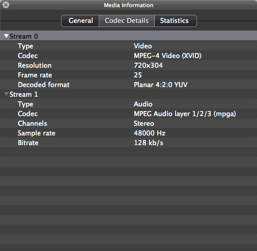

Post a detailed log showing you attempting to play a few of the files and lets see if that sheds any light. Also post MediaInfo details for one of the MKV's that doesn't play.

I have attached a screenshot that shows the CODEC info for the file I am trying to play.
