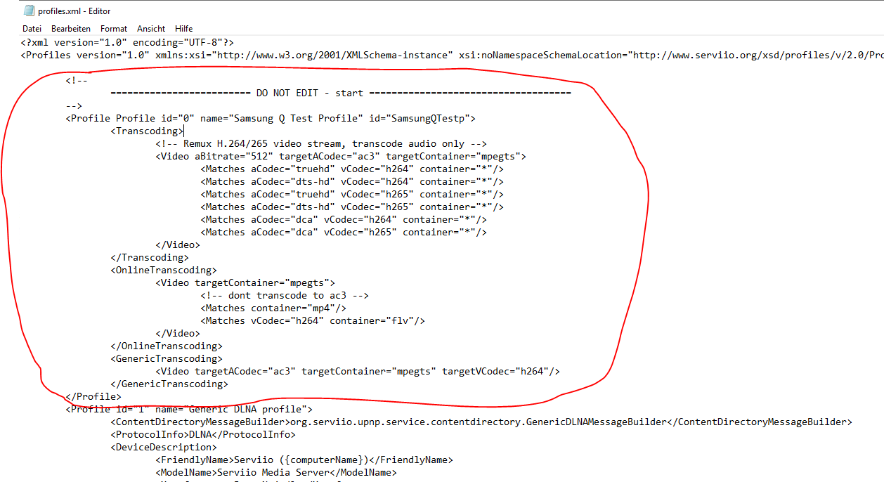

So now I have a problem. I've added the code as you can see in the picture "profile.png".
But now Serviio-Console doens't work. It always comes the message taht it cant reach the server. When I delete my code it still works.
Can you see what I did wrong?
Post Thu Oct 17, 2019 4:10 pm
Re: Where should I put the code for transcoding
Well, first I suggest you experiment with your profile in a separate file called user-profiles.xml. Then you aren't messing with the existing profiles. You appear to have modified the generic profile, or at least inserted your code in front of the generic profile, which you should never do. So first things first, restore the profile file, then we can look at what you are trying to do.
You should always start a profile by extending a previous profile, even if it's the generic profile. The generic profile (id=1) includes a lot of basic stuff that all other profiles need to know, so by extending from another you don't have to duplicate that info.
Don't give your profile ID the number 0. Instead use a name as you did on the same line. In fact, that might be the major problem, as you've included the Profile ID tag twice.

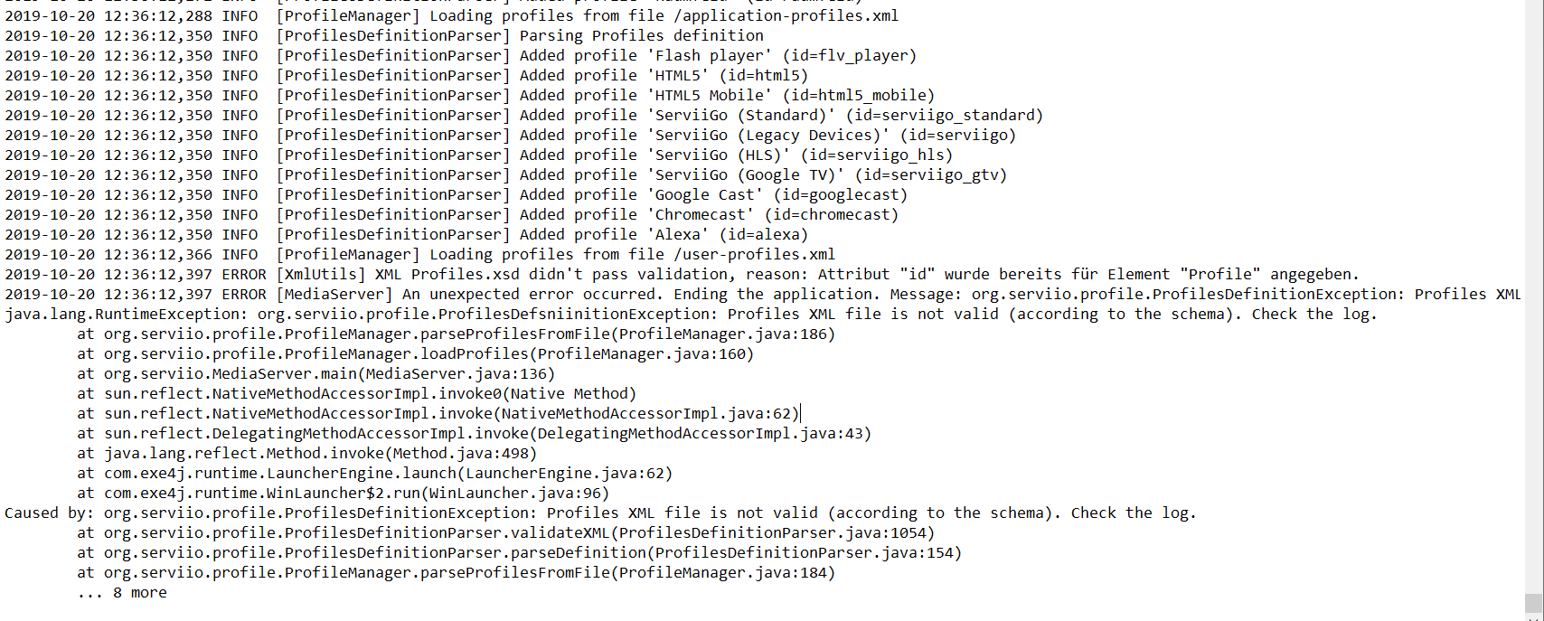

Hier anbei mein log.
Da kommen jedenfalls Fehlermeldungen an.
Post Sun Oct 20, 2019 9:54 pm
Had to translate what you said again. Sorry, I only speak English. :D
OK, I see the mistake. I should have caught it before. You have the ID tag in the header twice, at least on the last user-profiles.xml file you uploaded here. And I see that I doubled the error by including it in my suggestion. Sorry about that. You likely have this line, that I gave you in error:
Profile id="test" name="Samsung Q Test Profile" id="SamsungQTestp"   extendsProfileId="1">
and all it should have is:
Profile id="SamsungQTestp" name="Samsung Q Test Profile"  extendsProfileId="1">
My apologies for completely overlooking that before.

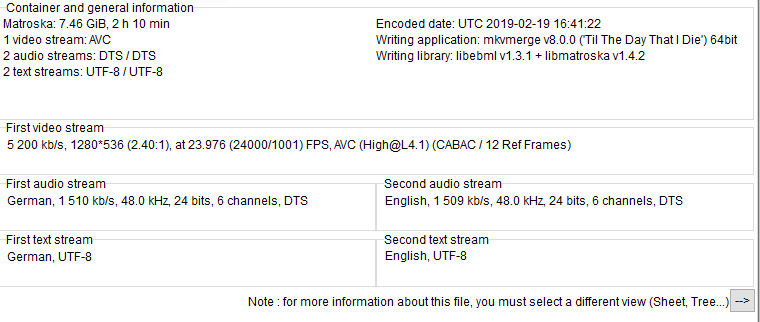

In the following picture you could see the media info of the file.
I think the problem is "AVC". How should I edit my file that it works with AVC and mkv or more?
Post Mon Oct 21, 2019 7:10 pm
AVC is video, and you are having an issue with audio. AVC is also known as H.264. Seeing your media info, I believe the issue is your media has DTS audio. Very few TVs can decode DTS. Just so I know exactly what you have now in your user-profiles.xml file, would you attach it here again, and then we can determine the best way to capture the audio and transcode it to AC3.
