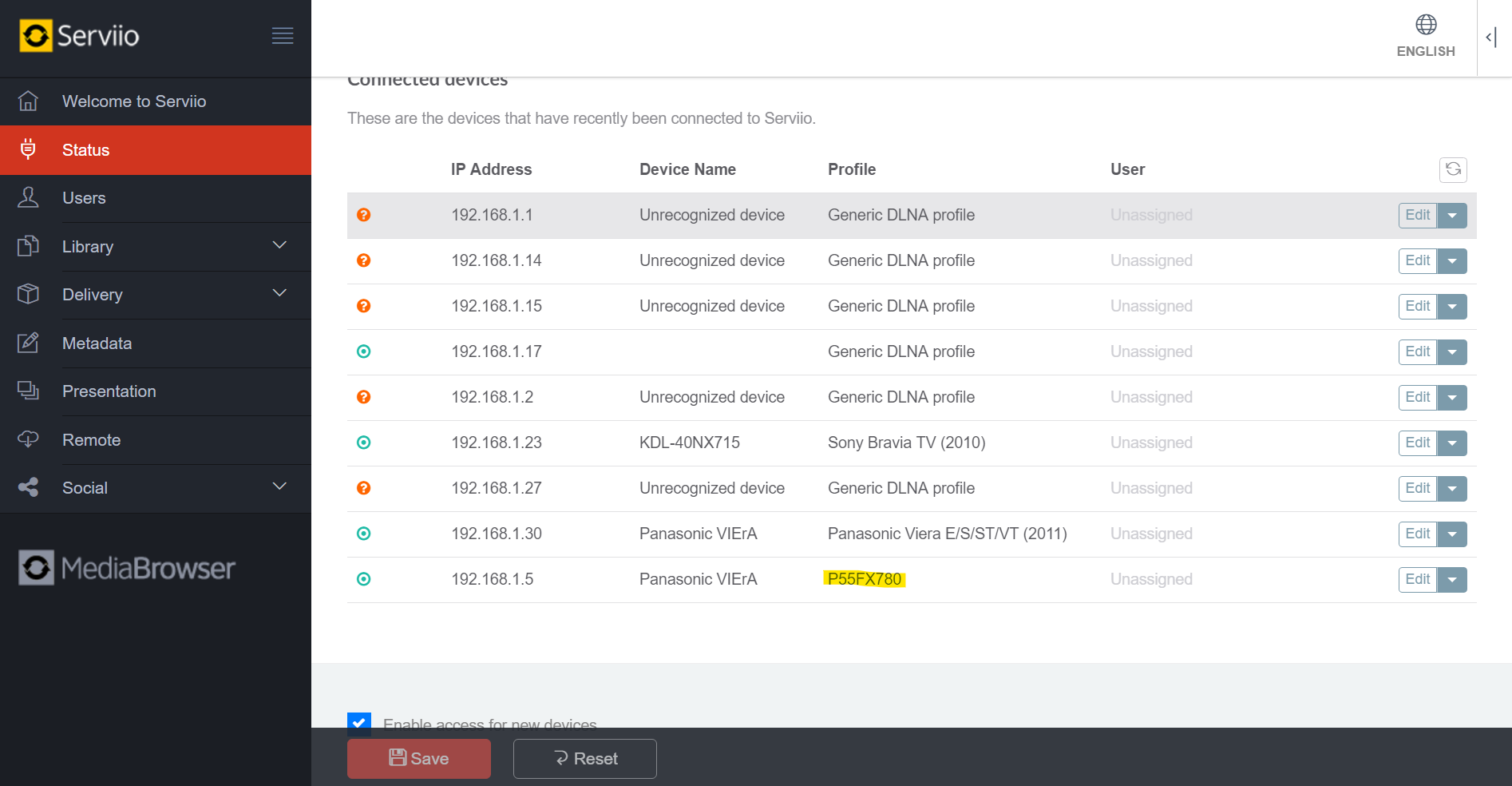

Yes I didn't use the same name for the profile, but it shouldn't be a problem and I have selected it as the active profile for the TV.
There is one line in the log that says the profile is active. The Name "Panasonic VIErA" comes from the TV itself. I have another Panasonic TV with the same name.
2021-01-20 18:23:08,478 DEBUG [VideoDeliveryEngine] Delivering item '1' for client 'Identifier=192.168.1.5, Profile=P55FX780, Name=Panasonic VIErA'
